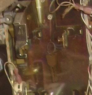

The inside was filthy, but pretty complete and unhacked. There were even keys on the coin door!!!
Unfortunately, they don't work in the lock. Oh well.

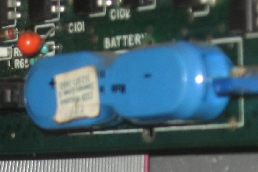

Also, the original battery had been replaced with something else. Anybody recognize this? Do I need to worry about it leaking??

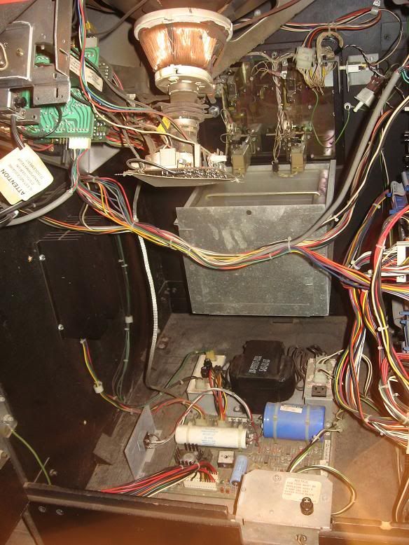

Seasoned Taito cabinet owners can probably already spot my problem in the picture of the inside, but I had no idea how to trouble shoot this issue. Plug it in, flip the switch, and nothing. Not a hum or LED or anything. It was just dead. I did some continuity tests on the power cable as it was pretty frayed, but it checked out ok. I knew about the two interlock switches, but I had them both pulled and still nothing. Turns out, there are the two switches behind the coin door, one for power and one for RAM or something. I had the RAM switch pulled thinking it was the power, but the power one was just dangling, not making contact with the coin door. This morning before work I got screwing with it again, pushed in the switch and pop... power... picture... upside down error message... close coin door (I had pushed in the RAM interlock as I fiddled with it).
Ok... I pulled the interlock switch out for the power, closed the door, and tried again. Power... picture... upside down error message "This location..."

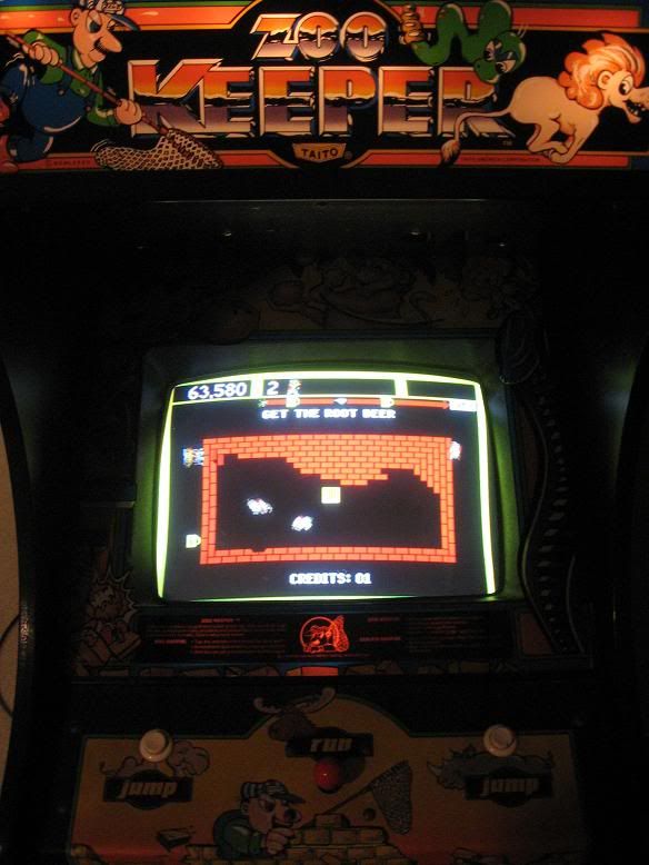

Ok... tried again. Power... Zookeeper music. I couldn't believe it. For as crappy as all the components looked, the machine powered up and I got 2 games of Zookeeper in before work. It was even saving high scores!! Although there were no high scores set on the machine already which I thought was strange. Anyway, I was pretty much high all day as a result of my success, be being a total newb and everything.

Dead +5V on a Taito power supply? Makes total sense. The title screen on every early '80s Taito game should say, "Hi, my name is Taito and I eat +5V power supply rails for breakfast."
Whether it was working right this morning is irrelevant. Original Taito power supplies fail if you breathe on 'em wrong. The only one I know of that is still working correctly is in Dokert's Zoo Keeper, and I think it had a voodoo curse put on it years ago that keeps it reanimated like the undead.
Let me put it this way... I own four early '80s Taito games: Qix, Jungle King, Zoo Keeper, and Elevator Action. Of the four only Elevator Action has its original power supply. The other three have had newer switching power supplies installed in them. Guess which ones work and which one is dead.
Elevator Action has marquee and bezel lights and a faintly glowing monitor, but doesn't POST. Why? No +5V going to the PCB.

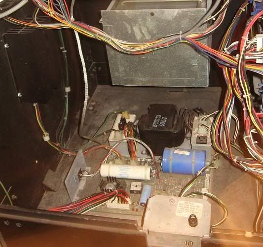

What's the solution to this? New power supply? Anybody have a good example of a power supply replacement that a novice can follow?
Arcade Shop sells a switching power supply with a Taito converter board on it so it's a drop in replacement. I need to order one myself.

Yes, the Qix & ZK use the same kit and it's very easy to install.
How much of the bottom of the cabinet does this replace?
Just the powersupply board?
The power supply board (that PCB in the bottom that has the giant blue capacitor and the big white capacitor) and the black box on the side of the cabinet (that's a giant heatsink for a couple of the power supply's transistors that run really hot; Taito just isolated them to keep them from burning up the rest of the power supply board).
Would I plug the new powersupply into the available outlet that's in there?
Nope, that's backwards. Your new switching power supply doesn't plug into anything inside the cab because it is what is providing the power. The switcher's cord will run out of the back of the cab and plug into an electrical outlet.
That outlet you see in the bottom of the cab receives power from the power supply. It is a service outlet that is not behind the isolation transformer. That means it is hot whenever the power supply is plugged in, not just when the cabinet's power switch is in the "On" position. The service outlet is there simply as a convenience for an arcade tech to plug in a light or an electrical tool without having to run an extension cord across the arcade floor.

You probably have cold solder joints in the power supply board, and on the EMI board (if there is one in the cabinet). On my EA, EVERY SINGLE connector on the EMI board had >75% of the solder joints broken.
If you have any soldering experience, it's easy. Pull out the power supply, remove the old solder, and add new solder to all of the connectors, and components that you notice with broken solder joints. Same for the EMI board, if there is one.
