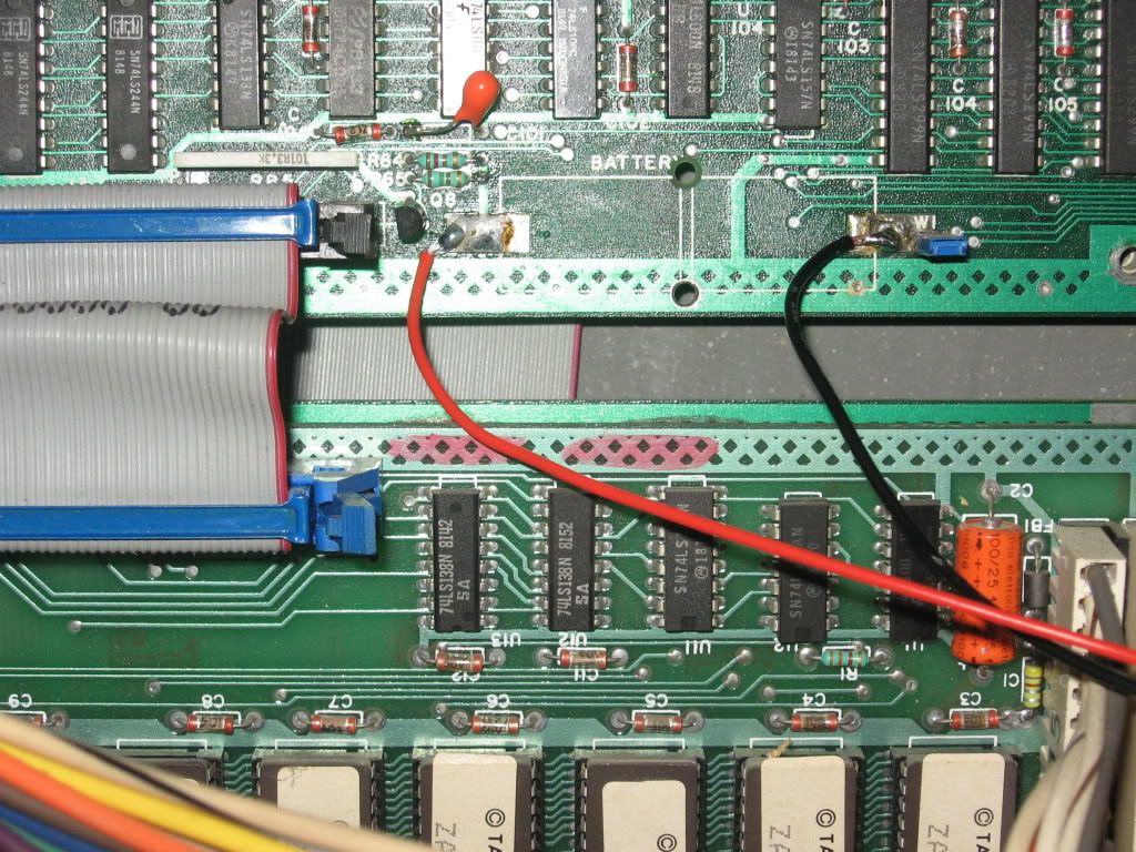

Alright fellas. I ordered one of these from Riptor:
http://www.pacmandotcom.com/kits/66-lithium-battery-kit.html
But being a newb I need confirmation on how to install it before I go soldering away like a moron and ruin my board. It didn't come with any instructions and Rip is not answering my PMs.
It came with a resistor and a diode. I think the diode is the black one with the white stripe. I'm installing this on a Zoo Keeper, so I don't think I need the resistor at all.
What I plan on doing (someone please stop me if this is wrong):
Solder the diode in line between the + on the board and the + side of the battery holder with the stripe away from the battery. Solder the - side of the battery holder to the - side of the board. Do I have this right?
Is there any problem in wiring it off board to make it easier to get to for replacement?

Here it is for anyone else wondering how to do this on a Qix / Zoo keeper board. The diode needs to be touching the two nearby resistors apparently.

I am so proud of myself. I managed to get my kit installed tonight, despite only ever have soddering one other thing in my life (a burnt trace on my ikari warriors extender card).
The tiny little diode was tricky:

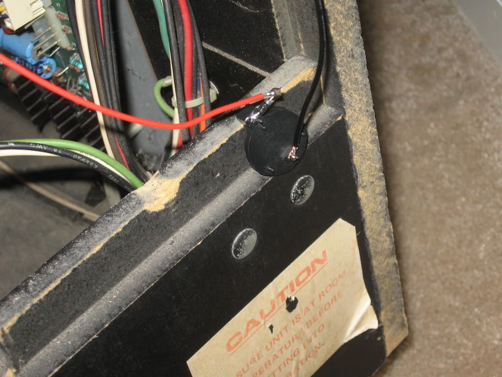

And I wired it off board to make it accessible from the coin door. This will also make it easier to replace with a battery pack if I ever want to.
But for the moment it's strung outside the cabinet incase I installed it wrong and it was going to blow up or something.
Powered it up, cycled through the menus, put some credits in, cycled the power and bam. It booted straight to the game screen for the first time in months.
One question: Do I have to worry about the diode ever failing? If it does fail, what is going to happen?

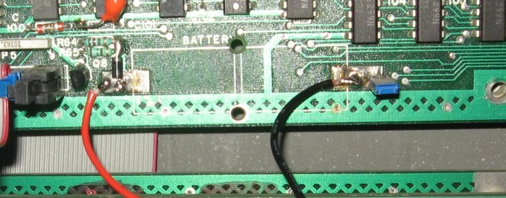

Rather than getting the diode to lay across those two resistors and having to cut the trace on the board, wouldn't it just be easier to put the diode in line between the board and the + side of the battery?
The easiest way is to cut the trace. With it intact its bypassing the diode.
Sorry, I overlooked this when I sent the pic.
Take 2.
I got the diode off.

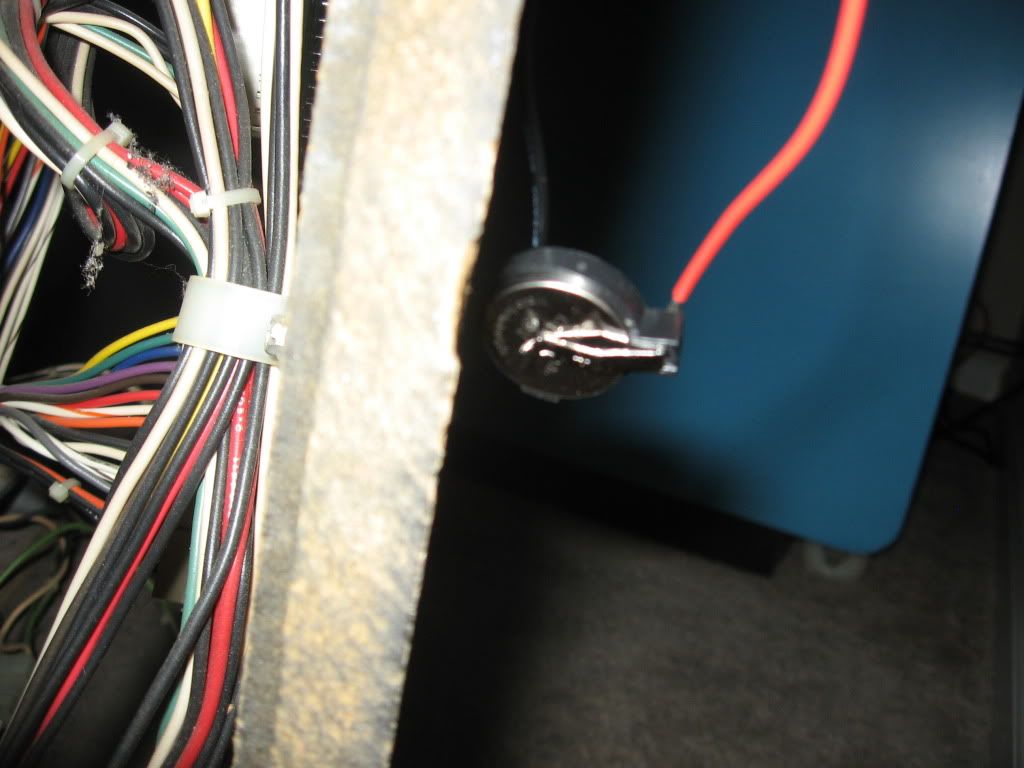

And I stuck it on the + side of the battery.
I didn't want to cut the trace in case I ever decided to go back to using nicads.
It's all working again but now I'm paranoid about not having it right. I heated up the diode pretty good soddering and desoddering it. Any chance its ever going to fail on me? How can I tell if it's doing its job?
