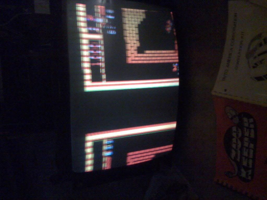

I took the monitor out of my jungle hunt (wg4900) to test my monitorless qix converted to zoo keeper cab for testing purposes. The zoo keeper cab is a verticle to horizontal conversion, not that it matters but, my wg monitorpic wont stop rolling. its fine in the jungle hunt but no matter what I adjust the pic just keeps rolling. My board in the zoo keeper is destroyed by massive battery damage but still somehow manages to display some what of a pic. Do you guys think the battery damage on the cpu board could be at fault for this?

Thanks Dokert ill get a pic. The image on screen is distorted slightly and has white jailbars. The screen horizontally rolls and I can adjust its speed down to slow almost stopped but it doesnt stop into the screen like its supposed to.
Most likely, the Zoo Keeper had a different monitor type in it than K4900. You most likely need to remove the negative vertical sync wire from the video input connector, as the 4900 doesn't like to sync if it's connected when using composite sync....
The Qix looks to have had a 4677 monitor and I hooked up to a 4900
