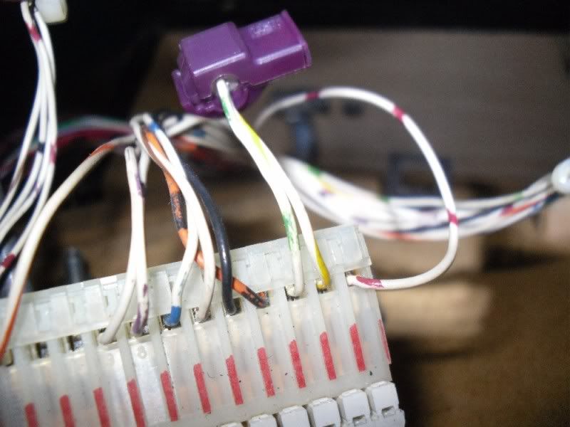

Ok, it's very easy.
Unlock the control panel.
Lift it up and flip it over exposing the gun harness.
You want to look for the flat, white 12 slot, 10 wire harness (each gun has one)
You need to tap the trigger wire to the pump wire.
This should be wire #2 and #3 from the right side.
Basically, this makes it so every time you pull the trigger you are also sending a signal that you pumped to reload.
So your ammo is never depleted.
This also allows a single person to dual wield both shotguns at the same time. (once you tap the same wires together on the player 2 harness)
It's great fun, makes it feel like a whole new game and is easy to reverse back to orginal pump action play.
*side note- while mucking around inside the actual gun assembly, after doing this mod, I happened to touch the pump wire near the recoil solenoid and the gun went on full autofire mode. Every time it recoiled, it fired and reloaded and since it recoils every time you fire it became a machine gun. Was a cool effect but not really practical for "normal" play.
