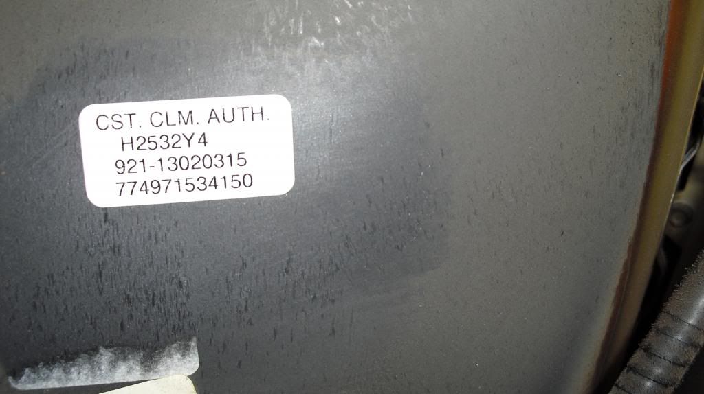

The numbers you post look to me like the model of the TV. The tube number is on the sticker on the glass tube itself. A 25" most likely will begin with A63.....
I personally wouldn't touch these. While I'm not a tube-swap expert, Zenith CRTs, from what I have seen, have had the shortest lifespan before having an unacceptable picture, and given that these were in hotel rooms, were likely heavily used.
for advanced CRT tube questions I would post in another forum like curtpalme.com or avsforum (both have CRT areas, start with curt first)
Thank you. I was unaware of those sites.
I agree with you completely about that. The problem is…… this is also the number on the stickers located on the glass tube. I cannot find any other numbers anywhere on the tube (or chassis for that matter).
I wanted to put this picture on here just to show you that I am not crazy. :)
Regardless, I had to go through several of them before I found one with tube # on it.
A63AGD01X
A63AGD01X = 6.3 volts heater, 50 volts G1, CR23 adapter
