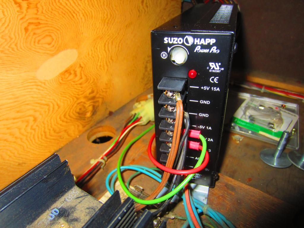

A friend of mine is having a problem with a Zaxxon. It's completely dead.
Replaced the power supply with a happ switching. AC wires moved from old +5 supply to the switching ps. +5 and ground wires moved over. -5 (orange) and +12 (red) from the pcb connector snipped and moved to the switching ps. Upon power up, the new switching power supply LED flashed on and off. No image at all on screen although it has glow.
Powered off and disconnected pcb connector. Power on - LED stays lit on ps. Power off - reconnect pcb - LED flashes on then off.
Pulled the pcb and placed it into a known working zaxxon cab with original power supply. Yellow screen - so the pcb is dead, but that doesn't explain the problem with the brand new happ power supply. Am I missing something here or could there be a problem with this brand new switching power supply?
Looked over the wiring again tonight. Everything looks fine. Maybe a bad power supply. There's no reason for that LED to flash on then off after the game is fired up. I didn't take any voltage readings however as I wanted to shut it down before any damage was done to anything.
