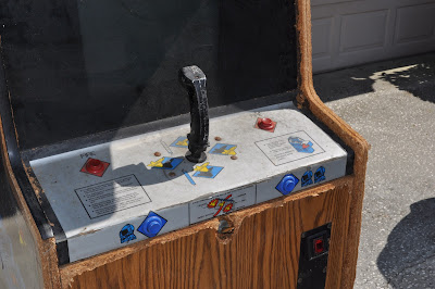

Ok so you've all seen the trashed out Zaxxon I posted a few weeks ago.
It really is bad. It's parked in the middle of my gameroom/work area, and it stinks and I think a new piece of it falls off daily. I cant wait to break it up and drag it to the curb.
My plan is to build a new cab and transfer the parts I can salvage. I know it's a common game, and I know they go pretty cheap. I'm just looking to develop my skills at cabinet building and restoration. I do love Zaxxon, it's a highly underrated game. Back in the day, this was a favorite of mine for a year or two, and I was pretty good at it.

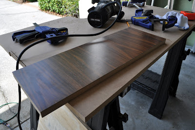

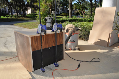

Im going to be using laminate to replicate the original woodgrain look. I started building the base of the cabinet this weekend. I think it's going pretty well. This was my first time using laminate and I can tell you that I'll be using it more often.
Here are a few pics of the new base section.
The woodgrain laminate is "English Oak" from Wilsonart. Its a little darker than the Sega woodgrain, but the grain pattern is very similar. Anyway, thanks for checking it out, I know this section of the forum doesn't get much traffic.
Looking really good my man. Zaxxon is a classic in my book. You using a router or a table saw? Cab parts look pretty precise so far.
Thanks Phet, I'm using a router for almost everything. My holy trinity: router, biscuit joiner, quickgrip clamps.

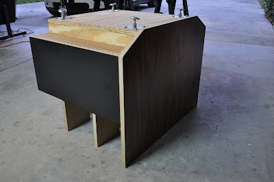

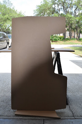

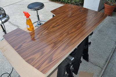

I managed to get the side profile cut out and laminated. My old cabinet was too damaged to get an exact trace, so I had to go with my best guess on the design. I spent a good amount of time trying to get it right, based on pictures from the web, and I feel pretty good about it.
And here is a sexy shot of it laminated. Merle Haggard in full effect.

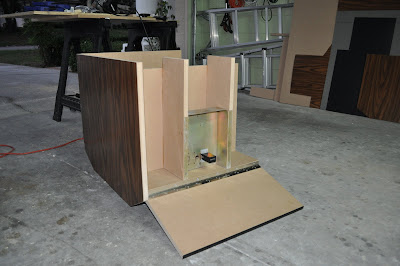

The base is almost finished, there are a few holes that need cut on the top piece. I also got the lock installed and the door shuts smoothly and flush.
It should start to look very good once I add the t-molding.
Best part of the day was washing up the old coin buckets and placing them in their new home.

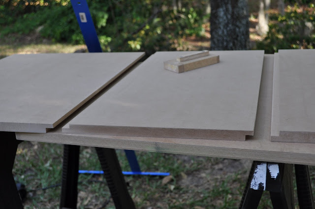

I didn't get much time to work on the Zaxxon this weekend. I spent an entire day, shopping with the girlfriend, aghhh. I finished cutting out the right side profile and cut out the pieces for the back, including the back door and exhaust fan opening.
One thing that really sucks about this cabinet, the top side profile sections. You can only cut one out of a 49" x 97" mdf. That also goes for the laminate. I tend to be a bit lazy when it comes to planning, and that's one that bit me in the ass.

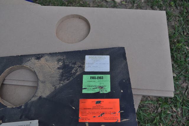

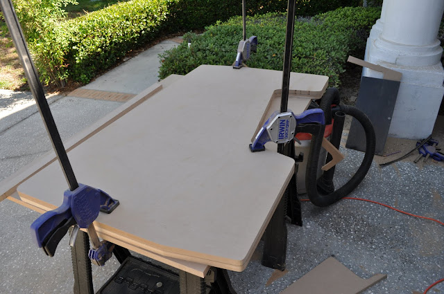

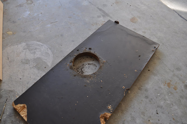

Here are a few pics of what I did today. I made a copy of the right side profile with a flush trim bit. The back three pieces were difficult to get right, but they turned out near perfect, and almost square. Fortunately the fan opening on the old cab was strong enough to just trace with the flush trim bit router. I'm looking at the stickers on the old back panel, it sucks that those are going in the trash.
