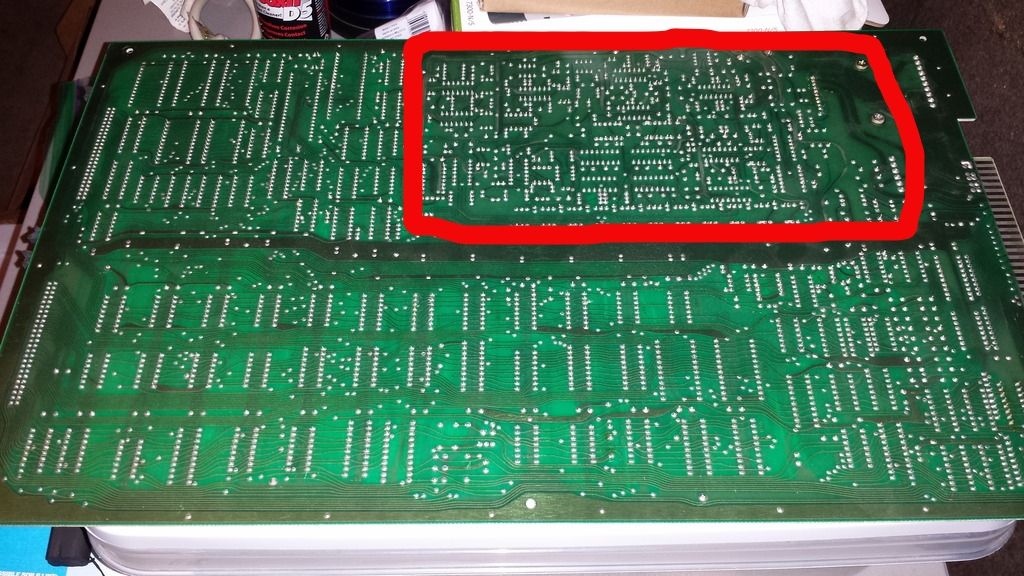

Im going to be doing the cap kit for my ZAXXON PCB as soon as my caps show up in the mail. There are thirteen 2.2uF 50v capacitors on the sound portion of the board that need replacing. Yes they are labeled on the front of the PCB and I am able to track them down fairly easy but when I flip the board over to identify where to desolder them HOLY MOLY!!! The solder dots are so close together Im already sure I will be accidentally unintentionally desoldering some things I shouldnt be. Im assuming there is no easy way to identify them when they are all this close together. Any advice for this noob as I decided this will be my first cap kit.

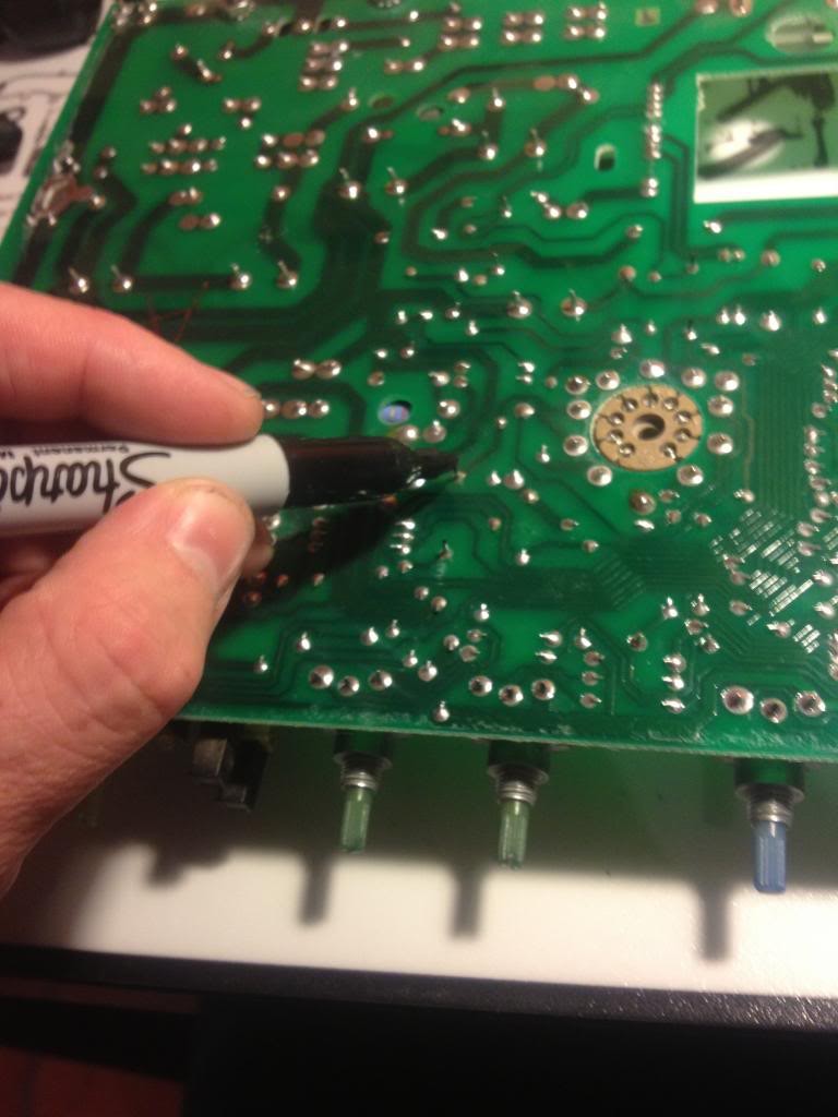

If you're not there yet, shine a bright light from the top side of the board, this should help you identify which things are what.
I also like to mark which things need to come out, particularly for ICs, where you can pretty easily pull one row off two separate parts, instead of pulling both from the correct one. I opt for a fine point dry erase marker, since it wipes off easily afterwards, but you could use a sharpie as well and clean it off with 99% alcohol. This would clean up some of the flux, too.

No, shine the light from the top side to aid you in locating the leads for the parts you want to remove. Touch the top of the cap, you'll be able to see the shadow of your finger on the back and locate the legs of the part. Mark the solder side with a marker.
That way, you have a guide for everything that needs to come out staring you in the face as you desolder.
sharpie that shit up!

Here is a link from a fellow KLOV member who did this cap kit. He included photos of the PCB that shows the area where the caps need replacing. The back side of the board is really what you need to see. The solder points are really tiny and close together.

I circled the area in RED that is tightly populated. This is where the 13 caps are all located and spread out. Nothing is labeled on this side of the PCB.
