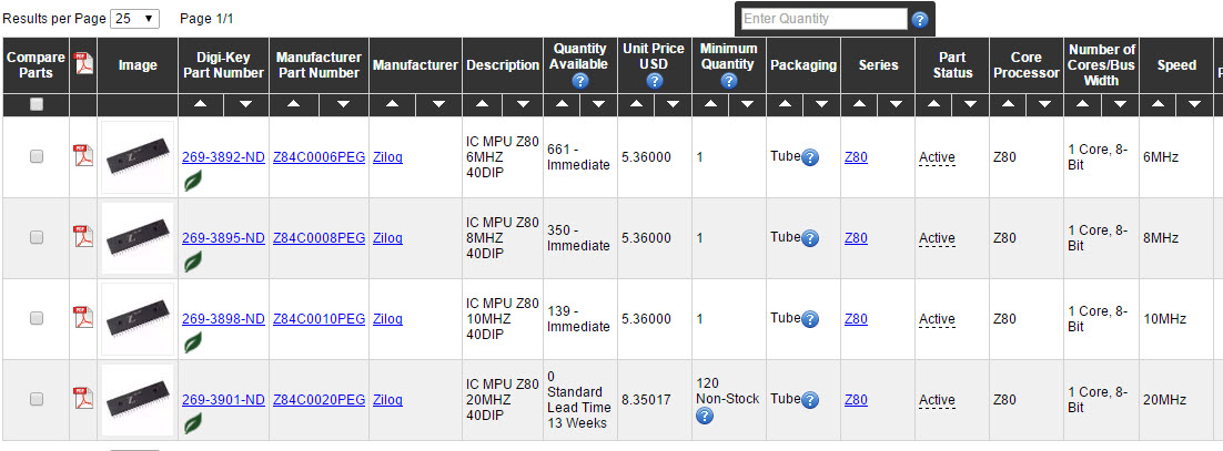

I have a parts order for Digikey and I wanted to add a Z80A for my Donkey Kong, but when I do search I can't find anything that resembles the actual ICU.
Can anyone suggest a correct part number that I should order?

https://iankellogg.com/catalog/product/view/id/90/s/z80-40-dip-20mhz/category/46/
http://www.digikey.com/product-sear...t=0&page=1&quantity=0&ptm=0&fid=0&pageSize=25

yeah, and the 20mhz z80's are out of stock with a 13 week wait:

What about just a Z80, as in the links provided? Is that good enough for Donkey Kong or do you need a Z80A. Are they interchangeable?

they are 100% interchangeable. At least as far as I have noticed. I've been using modern 20mhz Z80s in my repairs and haven't run into issues yet.

The plain Z80 is 2.5mHz clock
You cab run a Z80A in place of a Z80, but not the other way around. That is to say you can replace with a faster one, but not a slower one. ;)

So if the schematics spec a Z80A, and I ordered a 6MHz replacement, I should be okay?
