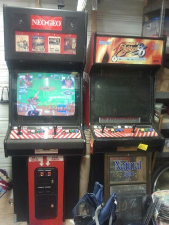

Haha you must have bought his OTHER Big Red then, the one with the speakers above the marquee. I have a pic somewhere of both machines side-by-side, I'll see if I can find it. Check it out, we have siblings! lol
You mean THIS picture?
Dude I'm trippin out! But it's cool to know my closest known neo neighbor and I are so serendipitously connected.
What all did you do to restore yours? I've actually been on the lookout for new marquee plexiglass for mine (mines got a crack in it).
Haha Yep, those are our girls! I did a full strip down and resto of mine. Here's a few pic of the cab, mid-resto. I bought two pieces of 1/8" plexi from Lowes and sandwiches the marquee between them. The marquee from your pic didn't come with mine, I had to buy a duplicate from eBay. I also had to replace the 4 slot mobo, completely rewire the coin door, and buy new credit counter LED boards and a memory card slot board for mine (George used the parts from mine in yours). Still tho, not bad for $50 lol.
As far as major resto, I started with enamel-based paints from Lowes: flat black and color-matched Neo Red (as I call it) along with the medium grey primer. There was a great big chunk of wood broken on the bottom corner of mine that I wound up regluing it then reinforcing it with wood glue and Bondo. You'd never know it had been damaged now. I replaced the stock T-molding with a nice deep red that goes great with the orange.
