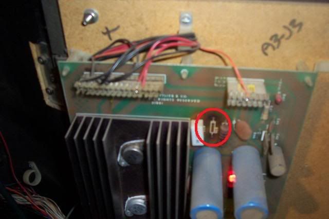

here is a picture of my power supply and in particular where the +12 should be.
It measures .10 at that point. solder looks recently reflowed on the back of the connector.

I've never had the blessing of working with a linear power supply. am I correct in understanding that each rail has its own fuse block, and that if the unit stops putting out a certain voltage that you just have to rebuild it?
read a lot about the fuse holders on the Williams/Midway stuff being of inferior build quality, could this happen here too?
ok I just rechecked the fuses on the power board
at positions:
f31
f32
the fuses are blowing immediately at power up.
when I got the machine they were dead, and had 1/4 amp 250 v fuses in there.
So that's what I replaced them with. I have no way of knowing if those are the proper fuses for those positions or not.

well page 8 of the reactor manual appears to show that the 1/4 amp fuse was the correct one. So if that is true I am blowing them fuckers at power up and need to figure out why.
maybe wiring this to a switcher should be in my future.

maybe trace the wires back, see if anything's shorted. see if anything's cooked, maybe. you're only missing +12, so I can't imagine it's anything majorly bad.
EDIT: by majorly bad, it's not like the PSU isn't working at all, the game at least runs, minus the sound.
What do you need? You should have the PS out on a bench, measuring every diode, transistor, resistor, etc looking for shorts, and then replacing parts as needed. Also, in that pic (if it's your board) it looks like a part is missing...
that's the advice I was looking for, thanks mod.
yeah that's the board, I didn't get the bottom half of it in the pic,
where some wires are coming out and going to numerous places in the cabinet.
but yeah I may be missing something, I wouldn't know.
It looks to me like you are missing D26, a 1N5363B zener diode (30v, 5%).
While this is needed for Q*Bert, I don't know if it is necessary for how that conversion was done...
