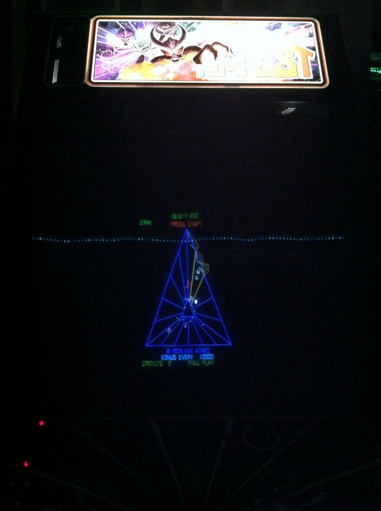

WINNER WINNER CHICKEN DINNER!!!
Thanks to Alejandromad I was able to get a replacement ROM at L M1 and guess what...
BOOM GOES THE DYNAMITE!! Very happy to have a nice working Tempest. Easiest fix ever. Damn this game is fun.
