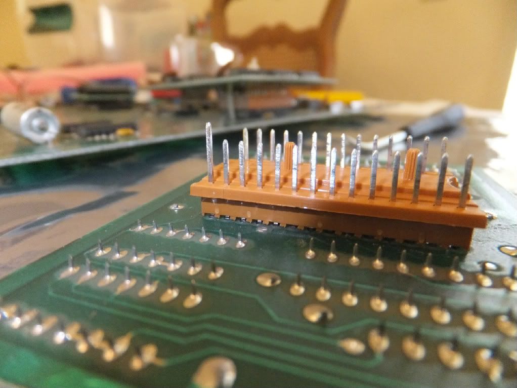

I purchased a Pac-Man cocktail on Monday, not working. I replaced all the fuses (there was a 2A in one 5A holder and a 3A slow-blow in a 1A holder) and after some fiddling with the monitor, everything was go. That's when it started having reset problems. It can play fine for 20 minutes and reset or it can boot up and then reset, no real pattern. After messing with it, I think I tracked it down to the Sync Buss card. If it reboots or throws up garbage, I press on it a certain way and it boots back up. So I took off the card and had a look and found this:
Pin 14 is so long that it actually goes through the pin hole on the rubber riser and out the other side, bending outward the thinner pin on that riser that inserts into the socket on the main board. Even though it appears everything makes contact fine, I can see that the Pin 14 socket on the main board has been widened a bit and may be the source of my problem (fingers crossed). Is there any particular reason that pin is so long, or is that a manufacturing error and I can cut it shorter?
