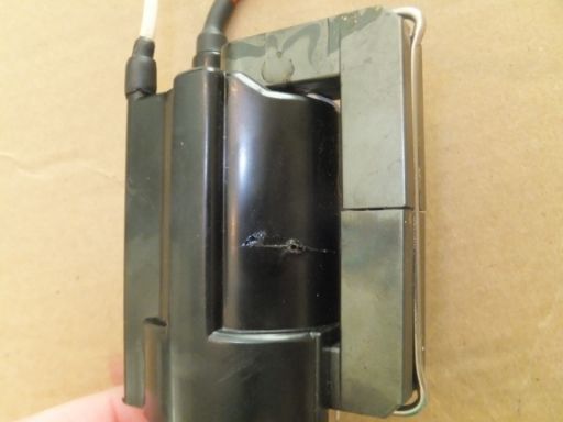

So I just got my new Sencore CR70 tonight and was going to try it out on the TM-202G in my PP2 cockpit. I had the back open and was getting set up while my daughter was playing. I heard, 'Daddy, what did you do?' I hear hissing, look up and white smoke is just billowing out of the side of the flyback. I just replaced this fly May of this year (bought it from Bob) along with a cap kit, less than 20 hours of run time. The original flyback had blown before I purchased this game. Did I just get a bad unit, are all replacement flybacks for this unit junk or is there something on the chassis that could have caused this?

I wonder... one issue this thing had was it took over a minute to warm up completely and the picture to show. Maybe the flyback wasn't good from the start? I wonder if arcadecup's flys are from a different manufacturer. I just wasn't expecting the replacement fly to go so soon. I'll probably throw a K4600 in there and just change the flyback sometime later and keep it as a back up. Lucky me, also have one in my Millipede.

Thanks for the link. That appears to be a new version rather than NOS. The one I replaced and the one in my Millipede have a black anode/cup wire and the outer 'handle' thing was cylindrical rather than squared off. I bet all the new versions are from the same manufacturer, but this one's cheaper than Bob.

Well, let the head banging begin. I received the replacement last night. I think my original replacement was a bad unit. As noted, it took quite a while for it to warm up. This new one has the tube showing a picture in about 10 seconds or so. If the TM-202G has anything going for it, it's the wide open chassis and frame. I had the new flyback up and running within 10 minutes, without having to pull the chassis. Below is a pic of the self destructed first replacement. I was a bit worried as it's the same manufacturer and if the number on the sticker (20020615) was a date code not only is it over a decade old, but they were manufactured in the same batch. Maybe it's just an internal item number? Anyway, fingers crossed, but I do still have the K4600 in the game.
