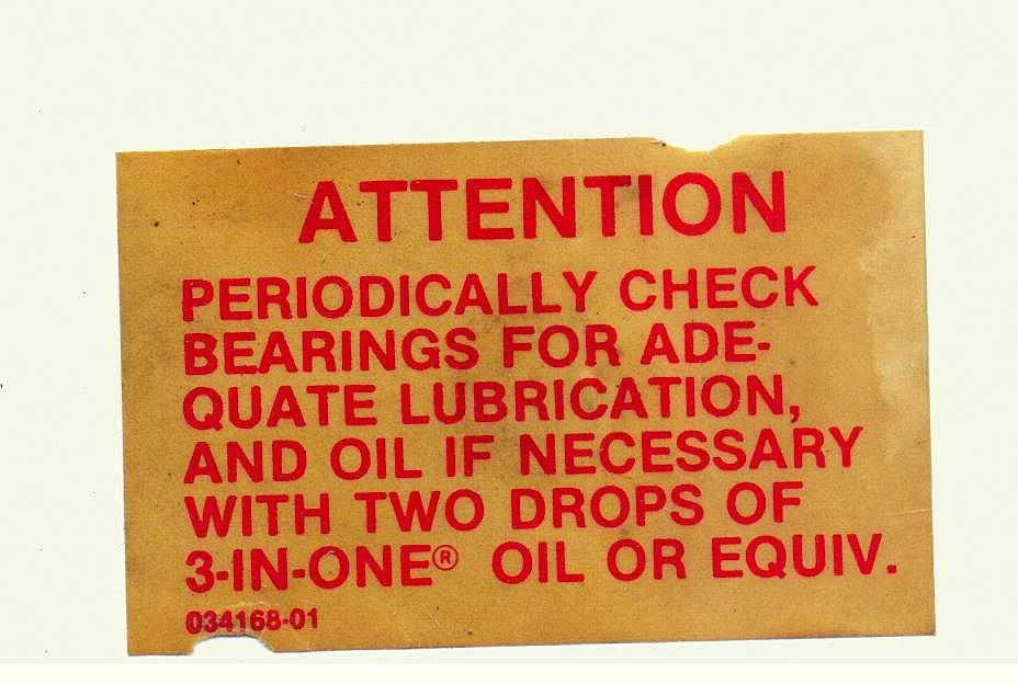

Looking into the yellow trackball mystery of 2009, I noticed a sticker on the bottom of it, that may explain the whole thing.
This sticker may have only been seen on this relatively uncommon all metal trackball assembly.
The sticker smelled faintly of - you guessed it - 3 in one oil or some related product and it was nowhere near the bearings. Very good chance that the coloration on the TB's themselves was not from nicotine or UV rays but from oil overspray or leakage.
If you soak a white vinyl or plastic trackball in oil over a period of 28 years or so - even lightly - it's going to absorb it.
I took some 400 grit sandpaper to one of the trackballs to see if it would get lighter (more white) or brighter yellow. It was the former. The balls are discolored, not originally yellow. At least, not the ones in my machine.
I replaced the ball in the TB I rebuilt with a bright white one. It's back in player 2's spot and looks terrific and rolls smooth as glass on rollers from Bob Roberts.
