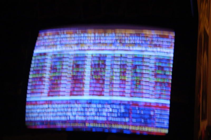

The thing looked like this.......
Blurry as can be and nothing fixed the problem. I tried resetting it a few times with no success.

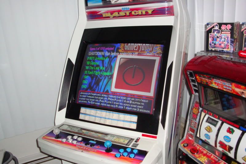

I had started to think that maybe I accidentally jostled something while getting it all hooked up and such. So I re-checked everything to see what may have come loose, and didn't notice anything out of place. Still upon another try out, the thing refused to display properly and I installed the board into my candy cab. Not only did the thing fire up properly on the first try, but it just looks so beautiful on my Sega Blast monitor. Crisp and clear as can be!

I've adjusted the 50.60 pot and it does nothing. I just threw a regular game in there and it worked fine. Then I tossed the multi board back in there and it now it flutters. Before it was just distorted, but the picture didn't move.
It's like shaking the dice with this board. You never know how it's going to show on the screen.

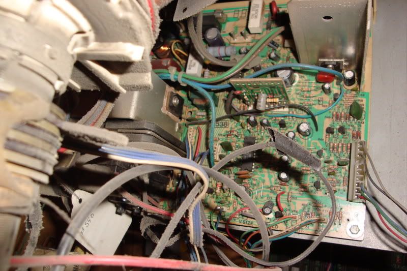

take a pic of the video input wires at the monitor plz...
Thanks for the input guys. I tried to get a snap of the sync on my monitor but my battery just died on my camera. So this is a temp pic until I can post one tomorrow.

could be the sync needs to be hooked up differently at the monitors connector, do you have any idea if this board outputs negatve or positive sync?
I have no idea about the monitor board, since I'm starting to learn about these monitors.
Playing with the 50/60 pot. I thought it would be like an on/off dial. (either it's on 50 or on 60) It seems to turn like regular pots that had gotten rid of my top screen curl problem I had with my CPS-1 board. Slowly with a bit of a turn fixing the problem.
looks like you have positive sync on the end pin only there( pin 10, closest tot he front of the game) if it starts giving you fits agan for giggles, try jumpering a wire to the empty cavity there so youd then have sync on both pins 9 and 10.
