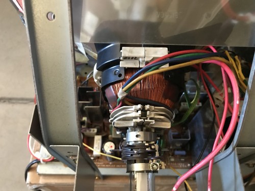

My Red Tent has a XM-1801N, in it and it had a blown fuse when I got it. Replaced the fuse fired it up and got a picture, albeit a bad one. Flyback was ticking/buzzing a bit and after about 2 minutes of running, smoke starts to come from behind, between the yoke and the tube. Could a failing flyback cause the smoke? I should mention that the picture remains on the screen even while smoking. It does appear also to have width issues.

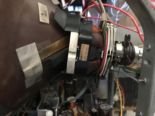

Does this count as burnt? What do I need to do next? This was my first yoke removal. Not as scary as I thought...
Yea, I'd say that yoke is burned up. Bummer. It probably had a short somewhere.
You could test it's ohm readings with a multimeter. But I suspect it's shot.

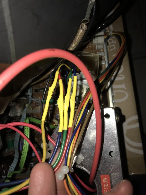

Putting the k7000 yoke on the red tent monitor was pretty straight forward. There a just a few things to keep in mind:
1. Obviously discharge the monitor. And be very careful sliding the yokes on and off. Also be careful not to be rough with the convergence rings. Those are old and brittle. Don't mess with them. Just take a picture where they were on the neck so that you can put them back in that same spot.
2. When you put the new k7000 yoke on, position it such that the yoke wires are coming out of the top of the monitor. If I recall, this is opposite of the original yoke you pulled off.
3. Slide the yoke down the neck as far forward as you can until it evenly rests on all the rubber wedges. (*Note you might have to pull the yoke away from the wedges later)
4. This step is important: The yoke molex on the k7000 yoke is not compatible with the red tent chassis. So you are going to need to clip that off and use the molex connector from the original yoke and splice the wires together. MAKE SURE YOU GIVE YOURSELF ENOUGH WIRE TO WORK WITH!
So here is how you wire it:
Yellow wire from k7000 yoke > connects to yellow wire on original yolk's molex
Blue wire from k7000 yoke > connects to red wire on original yolk's molex
Green wire from k7000 yoke > connects to green wire on original yolk's molex
Red wire from k7000 yoke > connects to blue wire on the original yolk's molex
Don't forget to put the convergnce rings back on, then tighten the yolk's set screw. Don't over-tighten it! You might need to adjust the yolk later anyway.
Keep in mind that when you first fire up the monitor, adjustments will have to be made. You might have to back the yoke away from the tube wedges. When I had it resting against the wedges, the colors were distorted on the edges of the screen. (The monitor looked like it needed to be degaussed) When I backed the yolk off the wedges about a half inch, the picture was perfect.
Might want to also verify your B+ is still 110VDC after doing all this as well.
GOOD LUCK. Go slow and be methodical! :)

@TheYeti thanks for the help. I just did a swap to K7000 on a Sharp 1801 using your info above. Made harness connections, dropped it on and pic is perfect again on an almost burn free Sharp. Just need to converge and lock it down.
