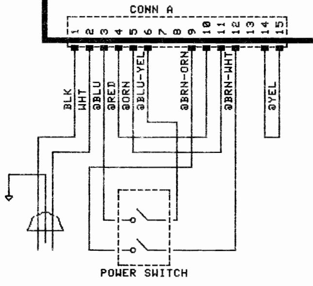

You may be on to something here. I had to remove the monitor to get the game in my basement. I had to unplug the monitor board feed and the four switch wires. The guy that sold me the game helped me get them back in the right place but I am not sure it is correct. The switch is difficult to explain because the posts are in a square configuration and it is difficult to relate what prong is correct for the schematic. This certainly could be one of the issues. The wires are blue, blue/yellow, brown/white and brown/orange.DSC_0089.JPG

Before disassembling ANYTHING ... always take lots of pictures. That's RULE #1.
With regards to the power switch, blues go with blues and browns go with browns. (See the diagram I posted).
Yours seems "crisscrossed". You should research this further before powering with AC again.
Notice that Line is on one side and Neutral is on the other. Example below.
If in doubt, remove the switch and look at markings. Use your DVM to confirm which two are related contacts.

So I should move the blue/yellow wire over to the terminal where brown/orange is and brown/orange to where blue/yellow is? I agree with the pictures but unfortunately for me the guy who sold me the machine also delivered it and it was about a 7 hour drive. He took the monitor off in like two minutes and before I could ever see what was what and then he left to drive home before my moving crew got it to the basement. I had to put it back together myself.
brown wires should be L, blue wires should be N. the wires with white stripes should be the output ones. I've never had to take one of those apart before, I'm impressed they use like European wire colors. :p
