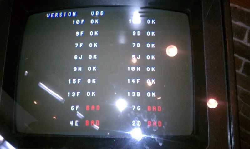

It has ran great since I got it with not one problem, now, it wont boot up, it gives me four ram errors. I pulled and reseated roms, to no avail. Is there any hope for these boards, or are they garbage once they go bad?

Looks like the chips at locations 2D, 6F, and 7C can be replaced if you can find replacements parts.
BUT, it's the Customer KONAMI IC at 4E that's got me worried.

1. 2D: HM62256ALSP-8 chip
2. 4E: 054539 KONAMI Custom Chip
3. 6F: 068 A01 KONAMI OTP Rom
4. 7C: LH168D-80L chip.
2D = 32k x 8 (.300) SRAM IC (62256 or equivalent)
4E = Konami Custom IC 054539
6F = Sound Program ROM...
7C = 8k x 8 (.300) SRAM IC (6264 or equivalent)
I think you'll find all of these are sound components... and I've noticed before that some of the control lines for the CPU to communicate to them go through that hybrid module... Probably where your source of problems are...

From what I've read, the sound problem doesnt generally cause the game to get hung up in rom check, is that right? Until I get the board repaired, I am going to throw TMNT in, only thing is, xmen has the separate connector for audio to the speakers, whereas the tmnt board does not. Is there any temporary solution to this without cutting wires in my xmen cab? Thanks for all of your input so far guys!
I had a Konami board with a hybrid module that was cracked through the middle... it would do the ROM tests at the beginning of boot then reboot and keep doing that in a repeating cycle.
This is why I believe that if you have a failing module it can cause it to do that.
When those caps leak they can cause connectivity issues between the legs and the traces on the ceramic substrate if the leak gets sooo bad that it reaches the edge of the module.

Did the leaking electrolyte reach the edge of the hybrid? If so, then you may have a poor connection between the top and bottom sides of the hybrid. There are IC chips and more parts (no electrolytics) on the bottom side of that module.
Did you check for bad traces on the top of the hybrid? You may have to jumper some of those deposited traces that are on the ceramic substrate.
