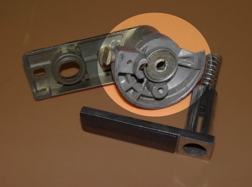

Pepsi machine came with the entire door assembly and even the keys....but not the actual latch.
I got no part numbers. I got no proper name. All I got is a photo with the component highlighted.
They can (and they ARE who I got the photo from as nobody else has a photo) however I do not require an entirely new latch assembly which is around $173CAD before shipping (so we will realistically say $200CAD). I was hoping that someone had just the one component, otherwise I would be buying a whole new assembly and discarding 90% of it.

I was able to locate a replacement set on Bonanza for $45USD before shipping. That was almost six months ago and I do not have a link to the guy but I think at the time he still had one or two more sets left.
Is the lock plug just sitting too deep or has the handle itself been trashed? You might be able to get away with drilling too deep with some careful epoxy work.
It looks as if you have the same machine as me. The cam that came with the replacement kit required the cabinet side of the latch to be modified, otherwise you could latch the door and it would jam in the locked position.
