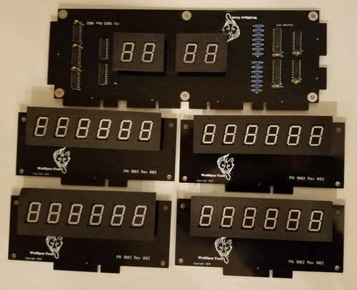

Looking for a 6 digit display for a Williams System 6 Gorgar machine Qty 2 if possible as one is fully dead and other is missing top segments, may replace with the new but if someone has a couple laying around for not too much let me know and I would rather go that route. Thanks

And one wonky display can cause other displays to error
Learned this one first hand.
If you are missing segments odds are it's a burnt resistor on the driver board. If it keeps burning up resistors it's a bad tube somewhere. This system drives me nuts.
It is an aftermarket driver board and they have been swapped to other outputs and it follows the displays. Appreciate the device I have reflowed others in past as well to fix them but not this system. Still looking for a couple to replace
Not sure if this helps, but I bought some aftermarket ones from Wolffpack. You need to assemble them with some basic soldering skills, but it's relatively painless. You can get all 5 for under $150 shipped.
Here's how mine looks. They are LEDs but look like the originals and blend in with incandescent backglasses nicely:
Here's me assembling them on a Live stream:
