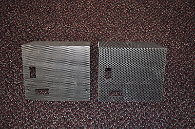

They didn't 'add holes' they went the sensible route and used a low cost off the shelf perf metal and bent it.
Umm.........duh????
Of course they used perforated sheet metal to manufacture it!
I meant they added holes to the fundamental electromagnetic design.
You're just picking fights now. Quit being so literal.
Having it laser cut is excessive and unnecessary.
I agree with that statement.

the good news is the company i used to produce these cages and covers for me do not charge extra for additional complexity of design. i could have the Monalisa cut into that sheet metal at the same cost of a single hole. and since my covers are the cheapest on the market you could assume my production cost was low as well.
