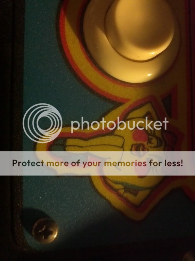

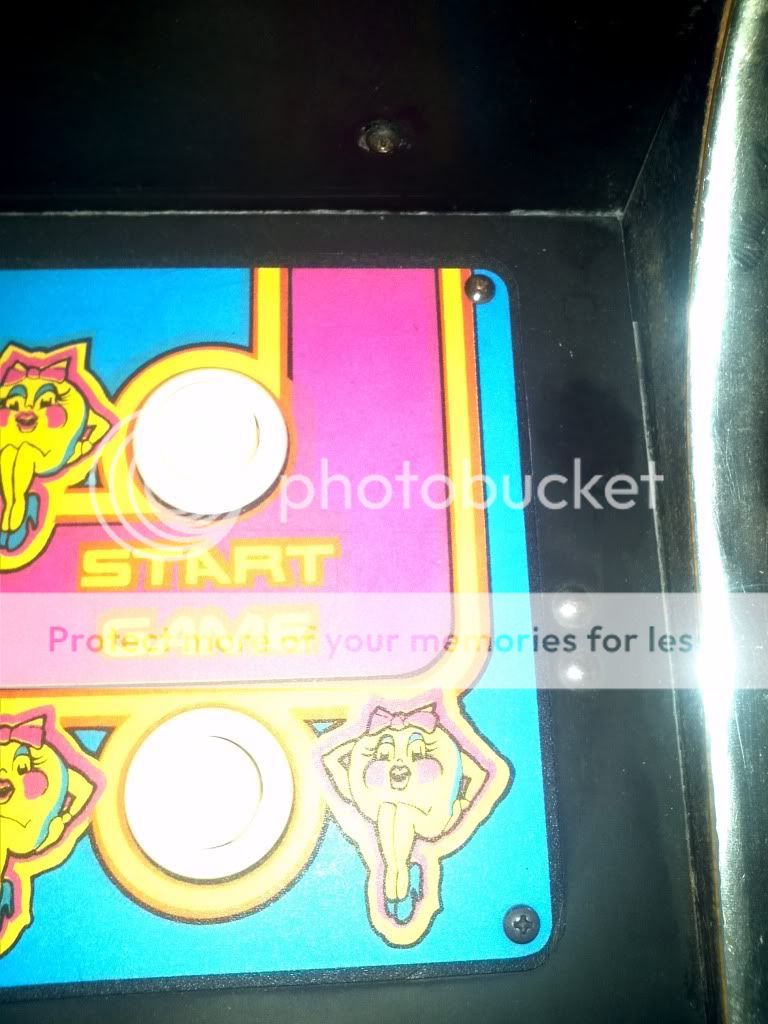

... also does anyone know what 4 outer little screws go on the top of the control panel? not the 8 midway carriage bolts but the other ones.
Here's the top right of my Ms Pac cabaret. The inner pair hold the latch plate. The outer pair hold the cpo down (and they are screws)

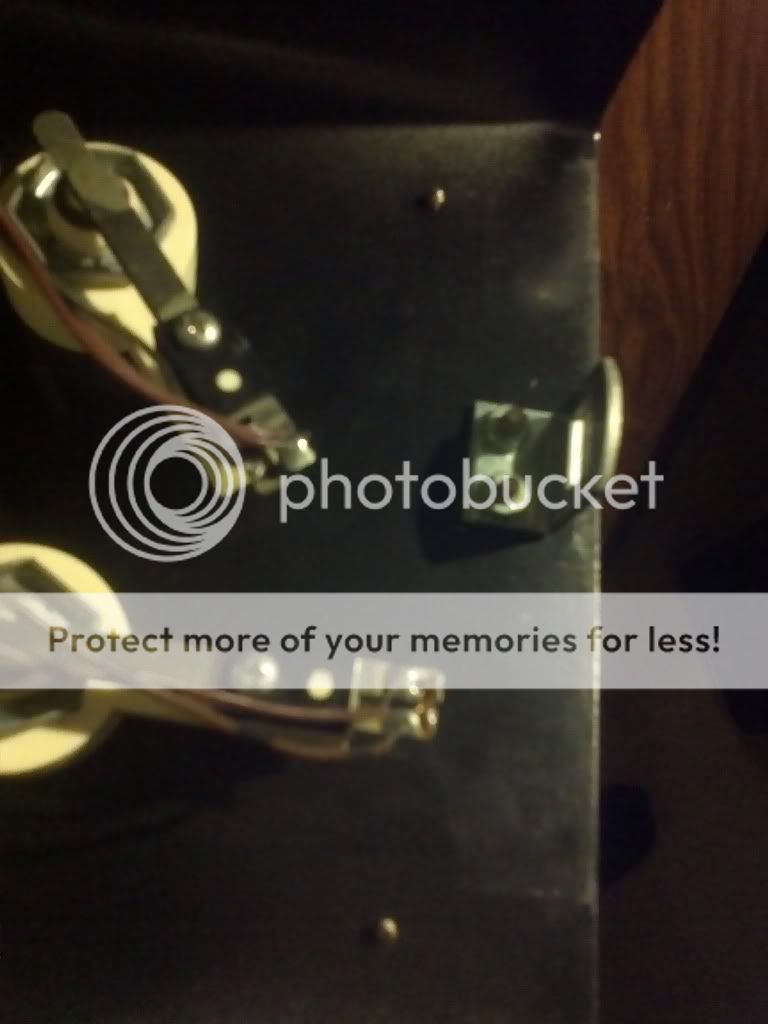

Here's the bottom of the same side of the control panel...
thank you for the pics and helping out, so there just machine screws then I'm guessing? do you know the size? because mine are all missing on it, I do have all the carriage bolts though.
According to the "Illustrated Parts Breakdown", section IV in the back of the Ms Pac manual, they are #6 x 1/4 Phillips head screws
