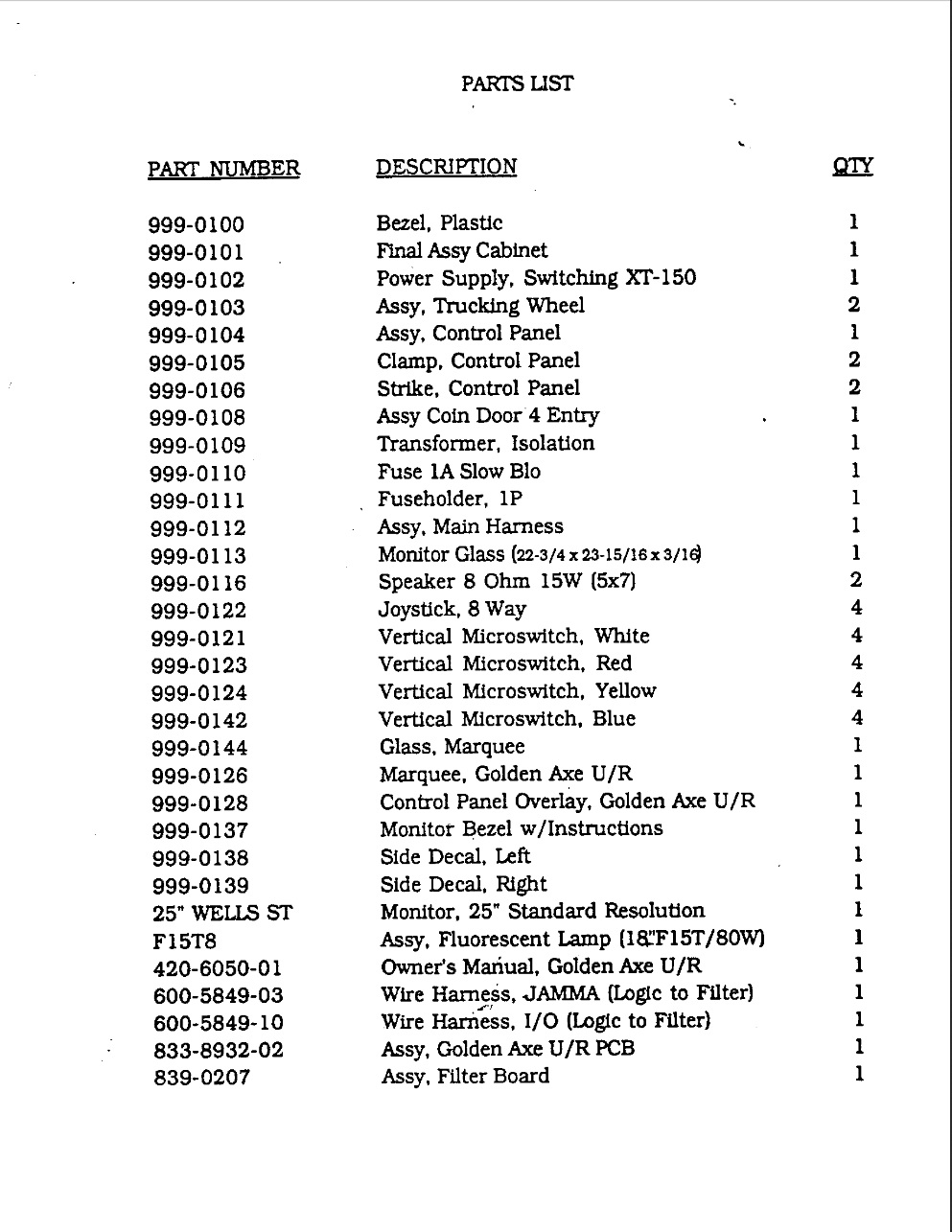

These parts are for my Golden Axe: Revenge of Death Adder. I have been searching for years.
If by chance you have a complete main harness or the JAMMA and I/O Logic to Filter cables I would definitely be interested.
Thank you very much!

Maybe a previous OP installed it in a cage and that's what was shown in the video. I wonder because the cage is not in the parts list from the manual. Or the Cage and PCB combined is part # 833-8932-02 Assy, Golden Axe U/R PCB.

The JST plugs on the filter board are 20, 25, 4, 5, 16 from left to right. I appreciate any help, thanks!

are you looking for this just for it to be like it was from the factory? I put a RODA back together (cabinet was completely stripped, and did use the filter board or anything. Just jamma'd it and then wired up player 3 and 4 using the headers off the board.

Hi man! Wow, really?! You just connected player 3 and 4 controls to the PCB itself? (837-7968) No filter is needed? Did you also crimp your own JST connectors? That is awesome, I would love to see it!! :004_sdrool:
I'm playing the game using JAMMA as well! but only 2 players since it's in a candy cab.. I am in need of some of those JST connectors to make my own Model 2 harness - which is kind of what the video reminded me of..
I had some jst plugs with some wire already attached and then added more wire to extend them to the control panel the pinout is in the manual
