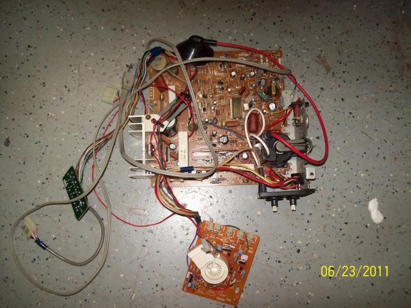

Well look what i found, all clean and pretty with new caps, flyback and no tube to go to. It's sad really.
