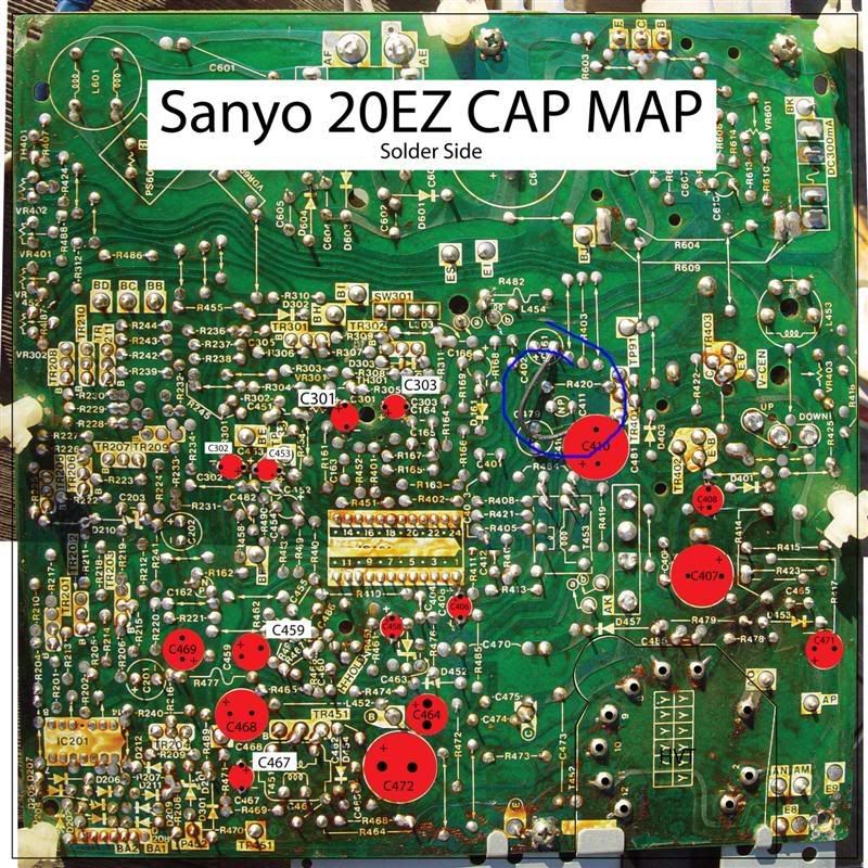

Hey Guys,
I just bought a DK cab and the monitor looks very dark and is only showing pictures in a very dark blue color. I'm looking to get it capped but from my phone conversation with a local monitor repairman he believes it sounds like the tube is blown. As a back up I'm looking for a great quality monitor I can stick in my DK cab. Looking for something with minor to little burn and preferbly something that was capped or just looked nice and sharp.

recap it, test color transistors. then if that doesn't work, give it a rejuve. i've brought a couple monitors back that were missing colors with a rejuvenator.

Cap kit itself - 20EZ 13"/19" - Deluxe Kit [Plus & Audio Bd Kit] - $12.00
do you know if these come with instruction manuals..or know anyone that does these on the forum? I think I would either kill myself or kill the board in the process
Cap kit instructions? There are pictures online of where each cap goes and the correct polarity. I think Bob Roberts might even include one with his kit.
If you've never soldered before it's probably not the best place to start, but it is doable.
Bob Roberts includes a cap list. You start from the top and check off each one you do. All you are doing is desoldering the old, make note of which lead is positive, then install new cap, solder in, and trim excess lead wire.
Here is a main board cap map, but there is also the neck & audio boards.
that is not a full cap map there are several missing locations that are not marked that i saw.

I am not sure if I would recommend doing a 20exz for a first cap project. The chassis is a bitch to get out and you have to take off the sound board and inverter (?) board as well. Save yourself a few hours of frustration and pay the piper. It's worth the money, trust me.
