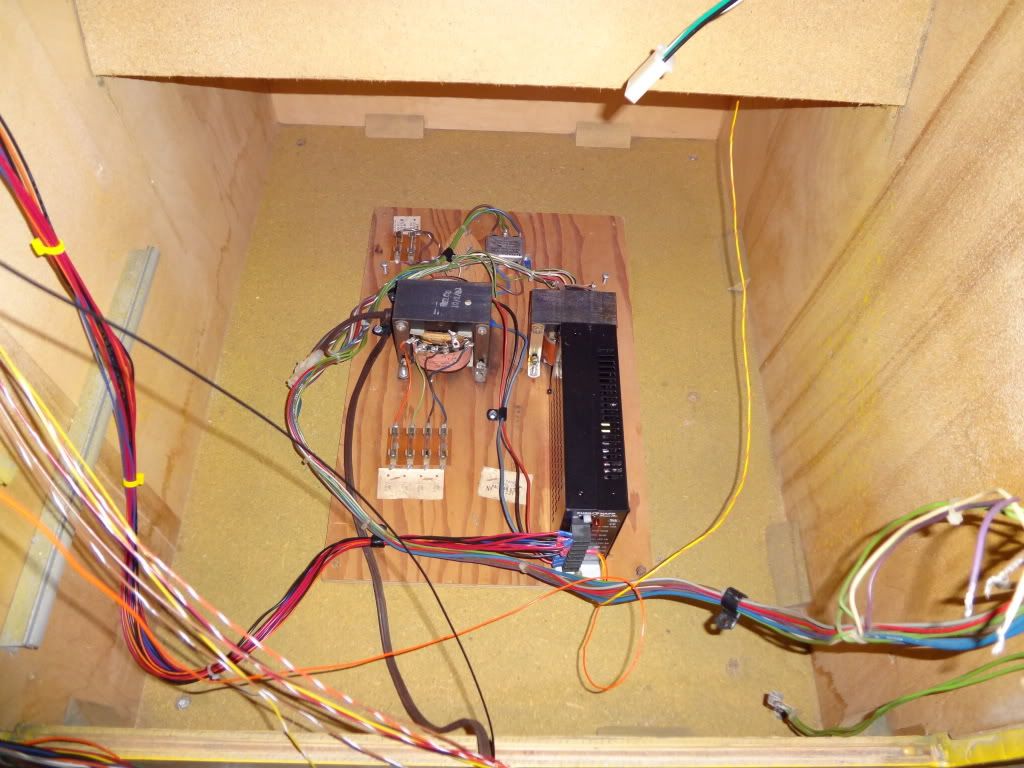

I've got a Ms. Pacman cocktail with the suitcase power supply in it. I believe it is introducing noise into the picture causing "rolling" through the picture. I'd like to change it out with a standard cocktail power supply. Anyone have one they are willing to sell?

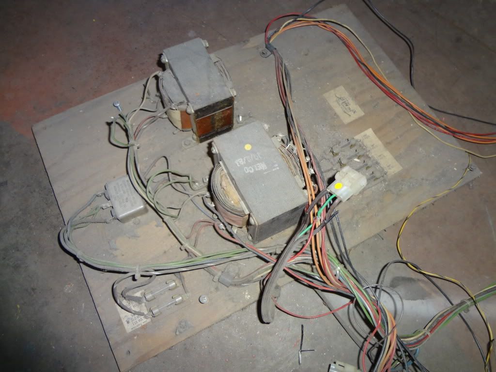

I believe this is what I would like to have in the bottom of my cocktail...just not so....weathered.

Sounds like the old problem of a bad fuse holder. that is if one of the fuses is not bad. Burn pins on edge connector.
I've replaced the fuse holders and fuses. I've installed a hum kit, capped monitor, shielded the monitor neck board, added a drain wire to the video cable.
When I tilt the lid open, the waves go away. I'm thinking this is definitely coming from interference created by the power supply.
I've even repalced the monitor
ms pacman
From what i read then it could be your board picking up magnetism from your monitor then.
Loosen the wire hold down,etc and connect board outside by control panel area and see if you have the interference still.
Loosen power chassis board and slide board as far as possible away from monitor and see if it gets better.
If not on all then one of the transformers is breaking down.
Try a switcher?
I should have both transformers.
I have a working Galaga power supply setup that Alphatron gave me. I'm going to give that a go.
