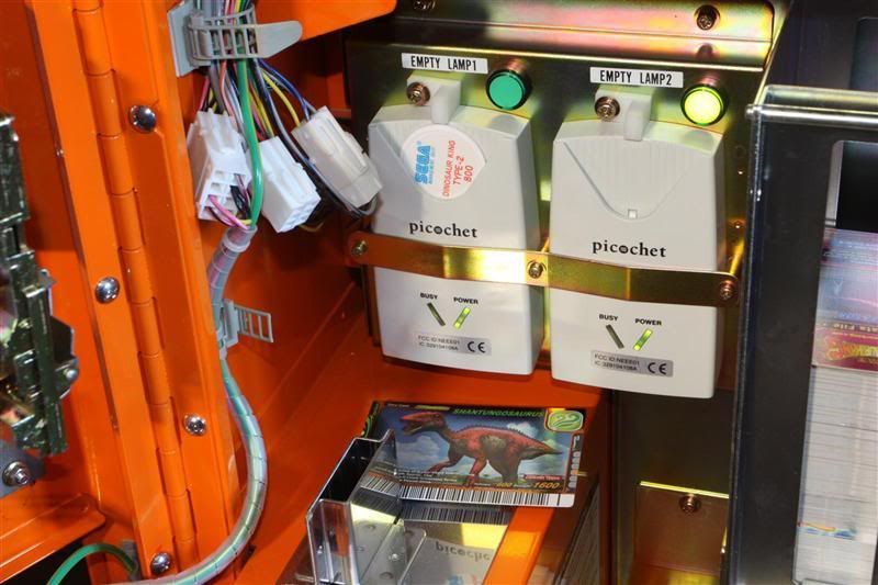

I didn't think that Oshare Majo was oficially released in the USA. I assume your machine still has vends remaining on the RFID chip (the 'Picochet' readers)? It will show you remaining vends in the test menus.

These collectible card games (Mushiking--> Oshare Majo--> Dinosaur King & probably more) were made by Sega to sell consumables -- the cards were sold in packs of 800 and came with an RFID chip that is encoded to allow 800 vends. Each play vends one card, and you cannot continuously recycle the cards back into the hopper as the machine will not vend when the RFID chip is exhausted.
I have to reassemble my Mushi-King setup to confirm but I believe the software just displays an error message until it gets a chip with vend credits on it. I'm sure the chip or the program code itself could be hacked but since it's supposed to dispense a card with every play it will become a brick unless you can find a source for the chips.

I have a Dinosaur King (2008 Special Edition) that has about 600 vends left, thankfully, but I never pulled the chip to see what happens.
To the OP: I'd be weary of the life you have left on that machine. Of course, you can buy all the loose cards you want and mix them into the hopper, but you're still ticking off the available plays until the RFID shuts you down.

yeah I know these have a short life, Andy at SegaShed has cards, and the kits to restore these to new, but at 350 GBP for the kit, it isnt cheap, I got a stack of those white discs with mine, is that the part that contains the data for plays? wonder if you can swap/convert/add different kits to it, like mushiking etc? as see the cart cheap on ebay, but guess still need the chip and cards :(
okay going thru the little white discs appears most are out of plays, have a couple that have about 266 plays left on them, as its RFID could you trick the game into thinking it has a new chip? bit like they hacked those skylander toys to become something else???
All the hardware is the same from what I've seen. It should be as easy as swapping the cart and the cards and the picochet chips to switch between games. Although if you have Love & Berry you are missing a few buttons on the control panel.
