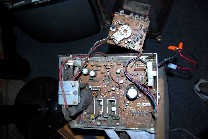

I also know of 2 versions of the Disco/Atari/ADI monitor chasis. I am curious if they use the same tube/yoke. I would assume they do but have not seen this information posted online to be sure. (I own both versions and can dig them out and take a reading if needed) Do you have a picture of your Disco chasis?
Here is a shot of my Disco chassis:
The chassis on mine looks just like that. I have a non-working Disco monitor and chassis. I'd like to be able to use it because it has almost no burn in from Gauntlet. Any info on what other types of chassis/yoke that will work is appreciated.
