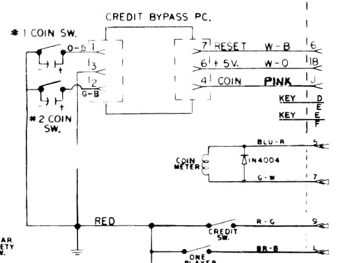

Looking at the schematic I'd guess 4 & 7 as they are signal in and out. The rest seem to be power, ground, etc. for the board itself.
pin 2 to pin 4 - pin 7 is reset from the pcb, whereas pin two clocks the flip flop. conn 2 to 4, drop a coin and if it coins up whoo hoo!
what i coouldnt tell form the schematic is whether pin 2 connects to one coin sw, the other, or the credit switch. check connectivity btwxt coin sw input and the coin 1/coin 2/credit switch to see whcih one it is conected to, with a dmm if you have issues
Got off the lazy train and found some info:
[FONT=&quot]Credit Bypass Board (7-pos)[/FONT]
[FONT=&quot]Pin | Definition[/FONT]
[FONT=&quot]------------------[/FONT]
[FONT=&quot] 1 | Coin Sw#1[/FONT]
[FONT=&quot] 2 | Coin Sw#2[/FONT]
[FONT=&quot] 3 | Gnd (to PS/16)[/FONT]
[FONT=&quot] 4 | (from CPU/J2-7, inverted, and to Coin Meter)[/FONT]
[FONT=&quot] 5 | Key[/FONT]
[FONT=&quot] 6 | +5V (to CPU/J3-7)[/FONT]
[FONT=&quot] 7 | (to CPU/J2-16)*[/FONT]
Also a snapshot of the schematic:
Should 1 and 2 be jumped too so they both throw the signal to 4?
