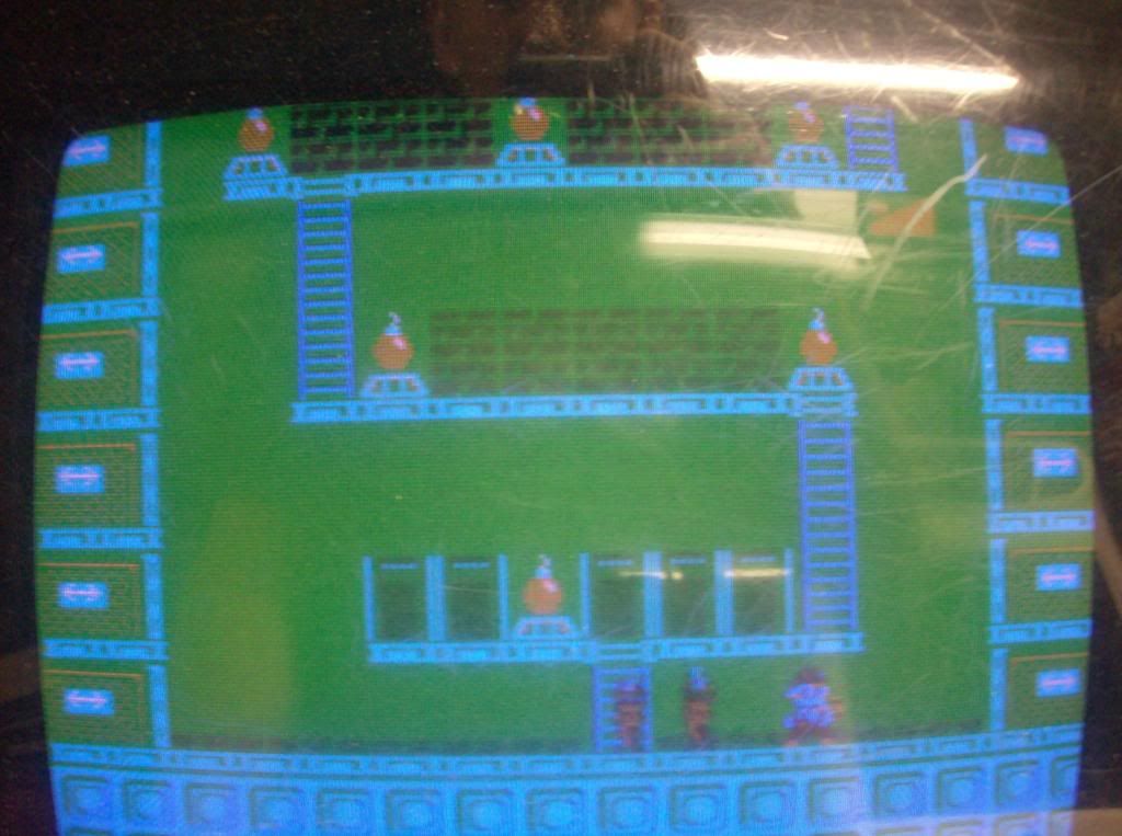

like it says i just got my spare pc10 up n running again but i only have 1 ppu
soo im loking for a boke old nes console (so i can steal the ppu from it )
ot im willing to trade the vs golf ppu i have here (works in my pc10 but i dont like green colors lol) for a ppu for my pc10
from what i have read the nes ppu will work in the pc 10 and vice versa
there are a few pc10 games that end up glitching out on the nes ppu but other than that its sposed to work
but thats why im looking for a CHEAP broken nes if it works cool if not im not out much
from the research i have done there are lots of guys using the pc10 ppu in their nes console because it gives a better picture
and there are several others that have used the nes ppu in a pc 10 because there are some conversion games that only will work with the nes ppu
also read of another person using the nes rgb-comp pcb inside the nes to consolise a pc10 mobo
golf ppu m akes my pc10 unhappy
Uh... that's a new one on me...
The CPUs from the Nintedo will work fine in the vs. boards but the PPU isn't pin compatible between the 2 systems. The vs. PPU has RGB output and the NES PPU has composite video output.
You'd have to do a lot of modification to the vs. board to have it support the NES PPU and even then it won't work with an arcade monitor.
RJ

lol really works great with the vs golf ppu but as you can see the color pallete is wrong lol)
