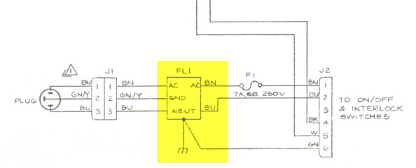

we tested/DMM'd before AND after the AC line filter. the filter is 100% perfect.

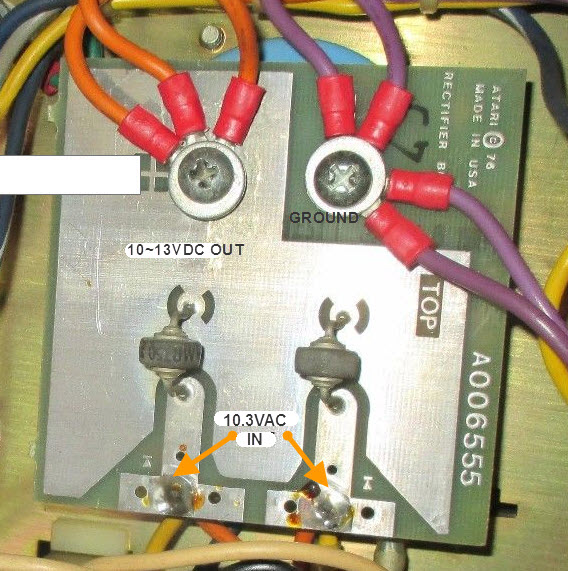

Flip the brick over and open it. Power it up, and be careful, as everything will be live.
Measure for AC at the inputs of the diodes on the rectifier, by putting your meter in AC mode, and putting the leads on the orange wires that go into the board with the diodes on it. What do you get?

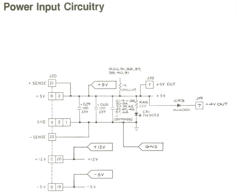

^ a mostly useless and confusing schematic... ^
^ that's the A006555 half-wave bridge rectifier pcb, i labelled accordingly... ^
Your picture is incorrect.
The AC comes out of the transformer, goes out/up to the fuse block, then comes back down to the inputs of the rectifier board, where you have your orange arrows. It goes through the diodes (following the direction marked by the diodes on the PCB), gets rectified, then smoothed by the filter cap, which is where the "10.3" VDC should be (which is usually actually closer to 13V on most bricks.) The lug of the filter cap is the DC output, not the two wires where your orange arrows are.
Check to make sure you don't have something wired up backwards, as your understanding appears to be switched around.
ugh, yer right. i reversed the IN/OUT and vac/vdc.
*** i have edited the photo and now its showing 100% correct yay!
