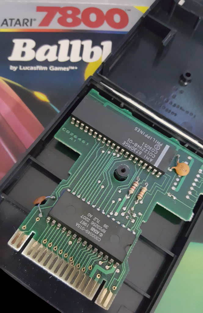

hey all,
does anyone sell or know of a good source for pokeys these days?
i have 1 good and 3 testing bad (P0/P1 in test mode) across my two millipede boards i'm trying to fix, need to find some replacements

So i've heard not all applications use all functions of the chip... Is there a way to find out what part of the pokey has failed? And then what part of the pokey is used in a particular application?
Ie: failed chip in P0 gives me only mushrooms dropped in the left column, in P1 gives me no bullet hitting mushroom sound... I'll see if the other two bad ones give different results

Constant firing and a Q error code are definitely a bad pokey, or if you're lucky a dirty or broken pokey socket. But it's easy enough to troubleshoot by swapping them, if you have another good Atari board and pokey.

Yes, if you have the means to desolder them, as they aren't socketed.

i may give it a try, never had to remove a 40-pin chip keeping it intact, but its probably worth a shot
tedious but successful
i took the last good one from the millipede board and fixed tempest, then took two from ball blazer carts (thanks scott), put them in sockets (so any extra solder wouldn't f up the socket on the board), and got millipede back up... still gotta pull two more for the other millipede pcb
the five bad ones i have now are all 1981 or 1982, 4 from millipedes are AMI/Korea and 1 from tempest is "S"/Singapore... all the ball blazer carts are 1987 or 1988 AMI/Philippines... for what its worth
