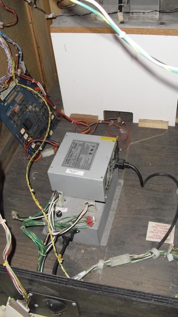

I have a Midway cabinet that I got with a broken ground lead for the wall plug at the end of the cord. I changed the plug, but accidentally switched the the energized and neutral wires. Hit the switch and caused a ton of damage to my chassis. I fixed the plug and tested the cabinet. Everything else is working fine (e.g., pcb, power supply, etc.) and the voltages are all right. I have swapped out another chassis but before I hit the switch again I was just wondering if there is anything else that may have been damaged that I should check before powering it on. ( I definitely do not want to cook another chassis.) Thanks in advance.

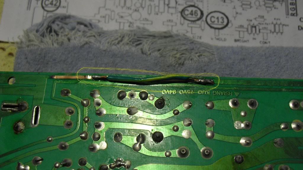

Thanks for all of the help guys. Here are some pics..... You can see two repairs I have already made to fix cooked traces on the traces. I still have some more repairs to do obviously.

I don't see an isolation transformer in your pictures. All I see is a power brick w/ an ATX power supply. I think LyonsArcade is on the right track. If there is not an isolation transformer, then there's your problem. The reason you didn't have a problem before is because the ground plug was broken. By fixing the ground plug, you now shorted your monitor to ground and "poof". Don't turn you machine on again unless your sure you have an isolation transformer. And, reversing the AC hot/neutral leads won't cause that kind of problem.

The isolation transformer (if the original monitor required one),along with a line filter, should be located in/underneath the gray box that the power supply is resting on. Where the power cord plugs in.
u sure?. the isolation transformer would sit where that ATX style power supply is sitting. Under the metal box it's sitting on you'll find 2x fuse holders and an AC line filter normally.
also kyros be more specific when you say k7000, mostlikely that's a k7400 i'm guessing as it doesn't have an iso, any other k71xx series would require one and wouldn't last long sans iso.
Jesus, I thought the same thing that this gentleman did. However, you guys were right, no iso. Damn, atleast now the cord thing makes sense. Thanks for the help guys and this is officially my first blown chassis because of no isolation transformer. Not a good feeling........
oh shit, I didn't see the picture. no, there is no isolation transformer underneath there lol

that design came along after a lot of the monitor manufacturers had models that came with switching mode power supplies (that didn't need isolation transformers anymore -- in fact they can be plugged straight into a wall outlet and I believe they can run on either 110VAC or 230VAC).
Midway either shipped with Hantarex Polos or Wells-Gardner U2000s around the time these cabs sprung up. that metal block literally takes the AC in to a line filter and spreads it to the two plugs on the top.
the previous models that did come with isolation transformers still (I think MK3 and KI were among the last ones) came with either the Polo or K7000.
I can't remember which games it was, but i have had 2 that had the iso tranny in that box. I only remember because i was shocked to find it when i stripped the cabinet for restoration,i picked up that power supply assembly and thought i was going to have a hernia because it was so heavy :) I pretty much have owned mostly midway dedicated games off and on for 10 years, so i know it had to be one of them. Perhaps it was a modification, but i know i had at least 2.
that sucks there was no ISO in there and the original owner of the machine was two cheap to install one when the monitor was replaced and took the lazy wrong way out to fix it.
