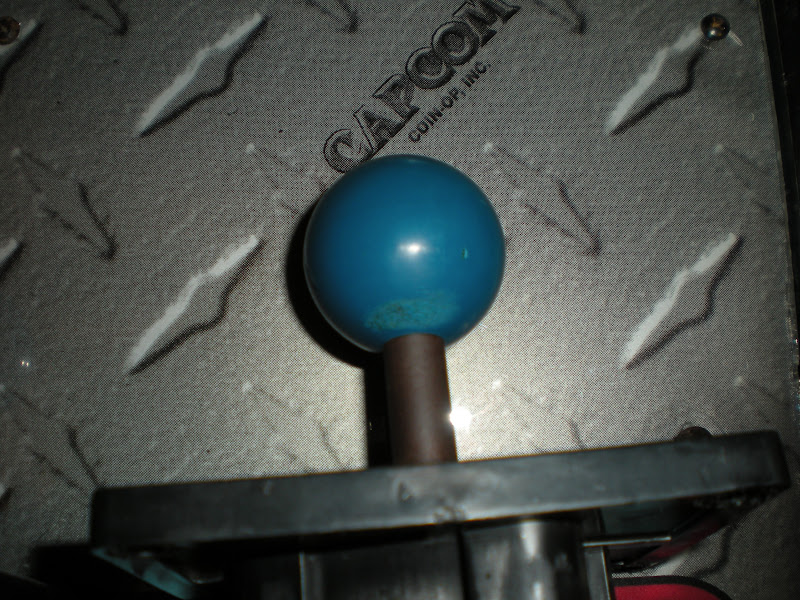

Here is what they looked like before:
Note the melt mark:

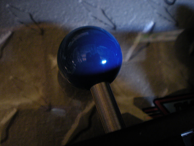

So now to how I cleaned them up.
  1. First, I put the sticks in my highspeed drill, then I used a fine grit sandpaper (while the drill is spinning the stick) and sanded out all the little dents and the burn mark.
  2. Second, I used automotive rubbing compound and a wet cloth and polished (still spinning in the drill) out the fine scratches from the sand paper.
  3. Last, I used automotive cleaning wax (using the drill) and gave it a high-gloss shine!

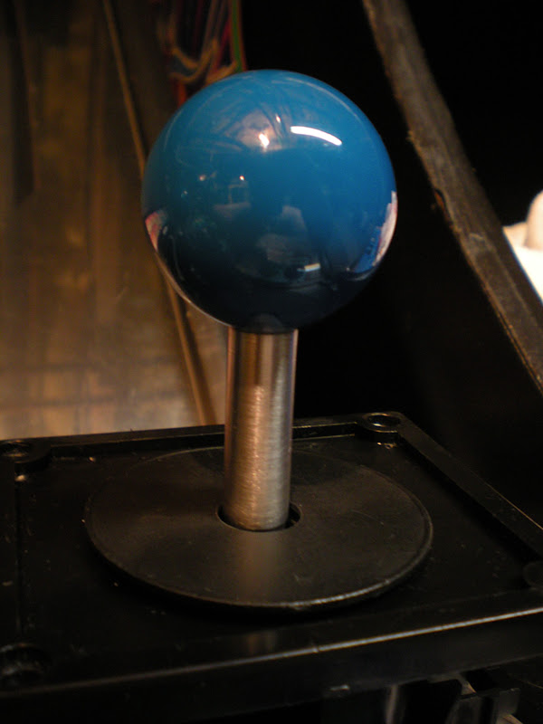

So here are the results, they came out really nice!
The burn mark is completely gone!

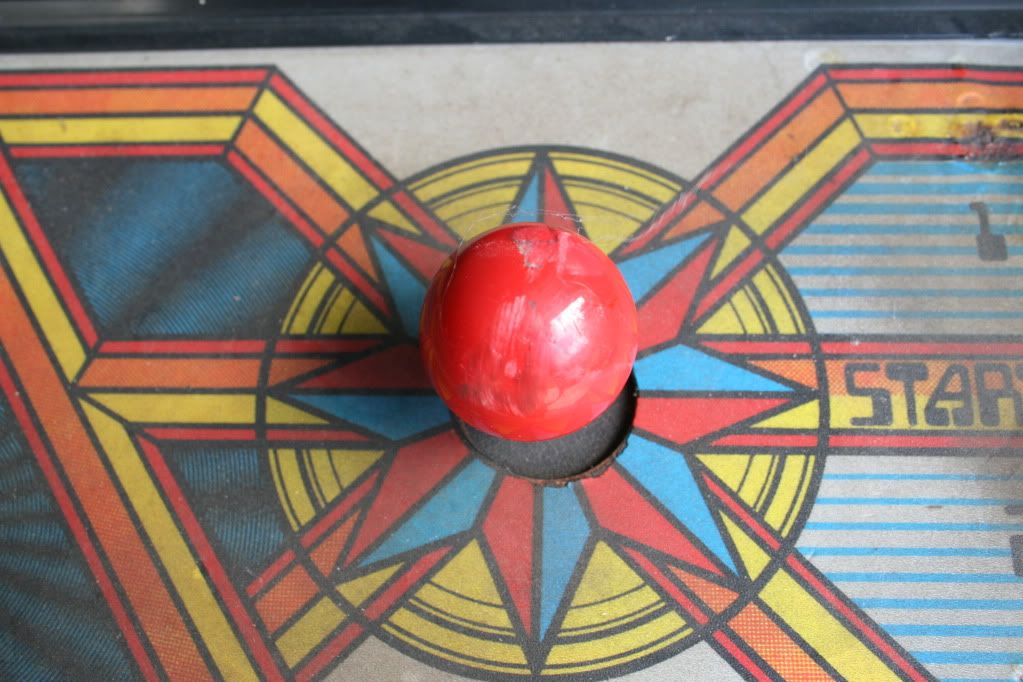

I ended up putting 8-way leafs back in the MW. However the 360's found a great home here....
Sorry that I only used one of the blue ball-tops, but Spikes favorite color is red.
