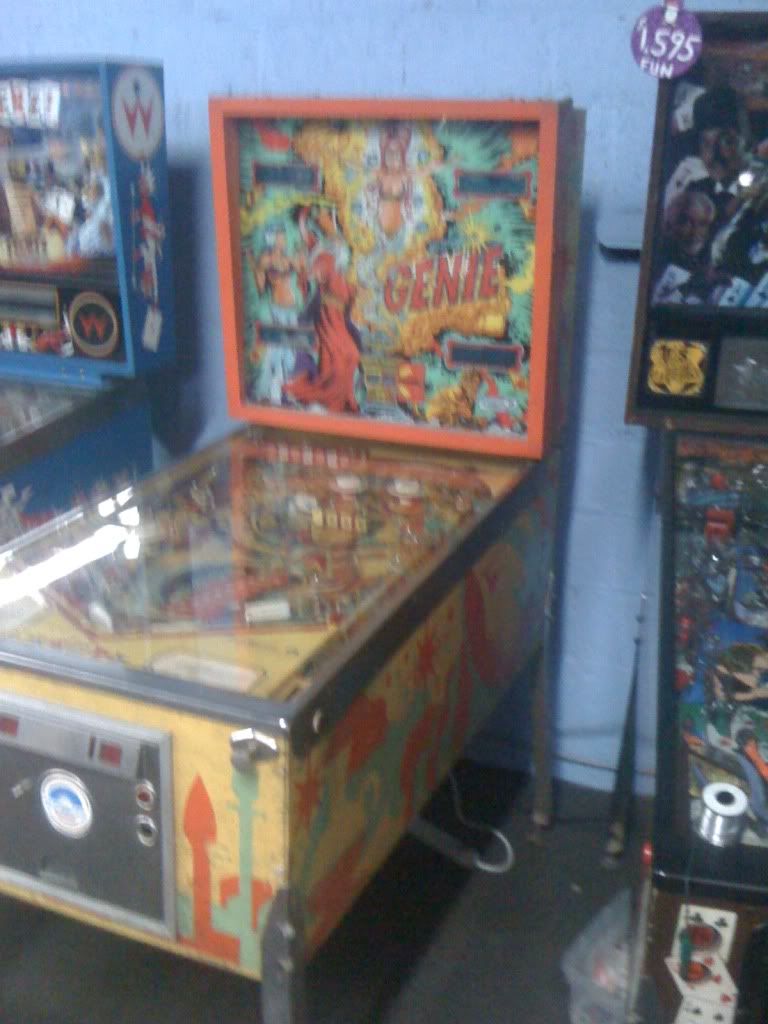

well a cl add poped up with a genie pin about 2 hours from my house stated as not working needs wiring redone
and since i have all my 3 pins up and running i thought id treat myself with a new toy for the holidays
soo

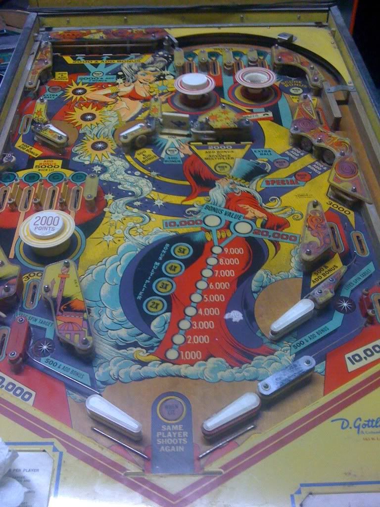

after emailing the person and finding out it was still avail for 150$ and reciving these two wonderful pics of the playfeild :)
i said what the hell if it works its worth the price even if the feild is not pretty under that mess of dirt and dust
well after 4 hours of driving i now have a genie pinball

after spending about an hour cleaning up the playfeild im left with a pretty nice playfeild
only a few little imperfections non really afect the play surface itself

wow thsats going to cleanup nicely.
I love it when theyre that dirty. THe dirt seems to help preserve the art underneath for some reason
lol yea thats the main reason i said f it and drove the 2 hours to take a look
my sea hunt pin was the same way totaly dirty but after a cleaning the sea hunt looks as if it was new
just got back from applying the first coat of wax so far there is the standard wear on top where the ball exits the shooter lane
and then there is one wear spot down on the wizards bottom right everything els excpt the plastics look awsome
gotta bust out the novus and hit the plastic next

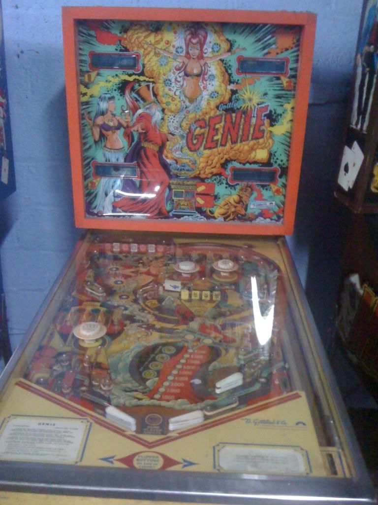

here she is as she sits now
Awesome!!!
