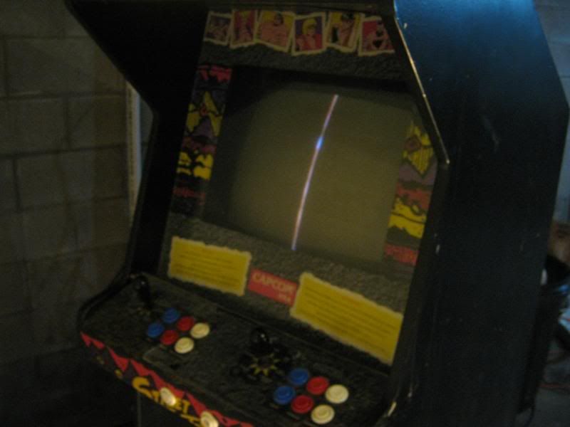

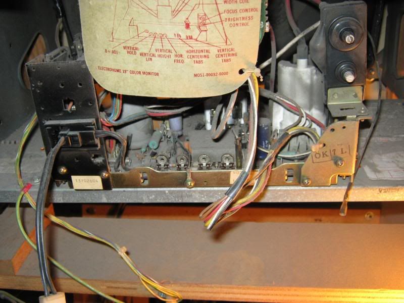

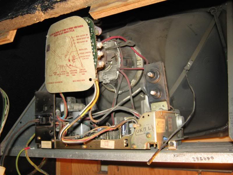

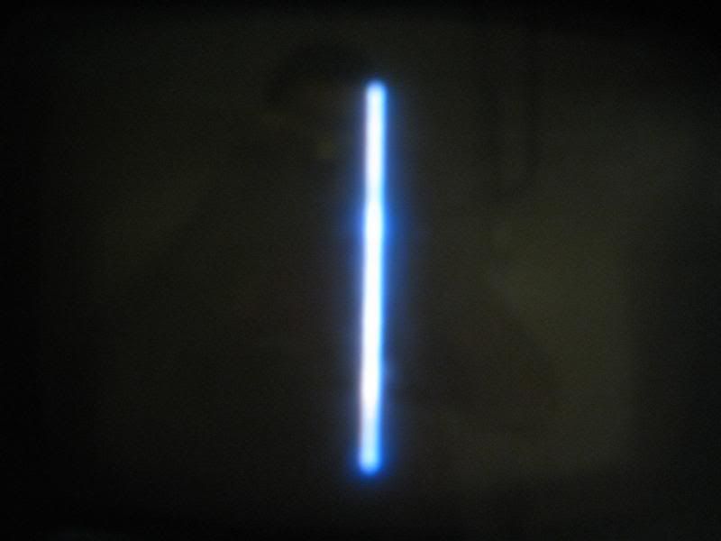

Got some progress today, comes to find it was the interlock switch, there was 2 instead of one and I didnt notice the other till today. It fired right up despite the monitor issue, it coins up(well with a pushbutton some one installing in the coin slot) here are some pics of what its doing and pics of this old ass monitor
Alright, you have an Electrohome G07. You also have no horizontal deflection. The LIKELY reason is either bad solder joints on the yoke, yoke wires that aren't connecting properly (I had one do that yesterday!) or bad solder joints.
G07's are notorious for having a distorted image. If you're decent with soldering, I would suggest putting one of Bob Robert's rebuild kits in it. Go ahead and replace the flyback at the same time; if you don't, it's likely to burn up shortly after you do a capkit. New flyback, new capkit, resolder anything that looks like it has cold solder joints, and you'll have a nice picture on your monitor.
You may want to give your horizontal width coil (in the back, on the right I think) a look, if it's broken it'll still work, but if it's completely broken in half at the wire it'll do exactly what's wrong with yours.
Good news is you have Vertical deflection! LOL.
OH, P.S. your four wires in front of the flyback on that big plug are your yoke connections. While somebody's watching the front, very, very carefully (so you dont' touch anything else!) wiggle the red wire, and wiggle the white wire. If that makes your image pop out wide, carefully see why those two aren't making good connection.
OH, just noticed something else. Before you turn it on next time, see that big thick wire hanging off the right side of the tube? That goes to the ground on the neck board. I don't believe that would cause the problem you're having, but it just might cause others if you don't plug it in. If you carefully remove the neckboard (power off) by gently pulling it straight back off the pins on the tube, you'll see a flat prong that might be labeled ground, or "grd" or something like that, it should be shiny and not as dusty as the rest of the parts, because that plug slides over that, grounding your chassis to the tube.
