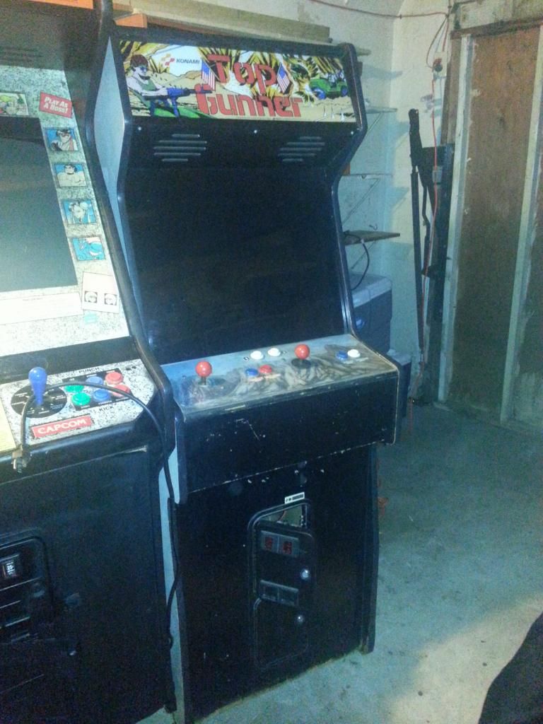

I was thinking about painting this cabinet Nintendo blue and turning it into a 60 in 1. It used to be a Devastators, then converted to a Top Gunner. It also has 6 carriage bolts sticking out of both sides (12 in total). I know it's not a Nintendo cabinet, but is this cabinet rare enough that it would be a horrible thing to do to it? This is the cabinet:

Thanks! Sorry, I actually think it is a Joust 2 cabinet, it has a 19" vertical in it. I was also wrong, there are only 4 carriage bolts on each side. I am not sure the about the history of the cabinet.
http://www.arcade-museum.com/game_detail.php?game_id=8244

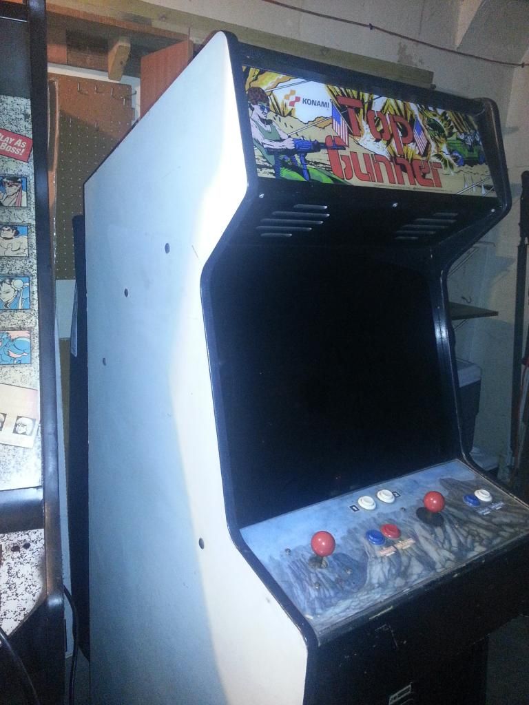

Here are some pictures of it:
There is some water damage on the bottom, hopefully it will clean up nicely though.

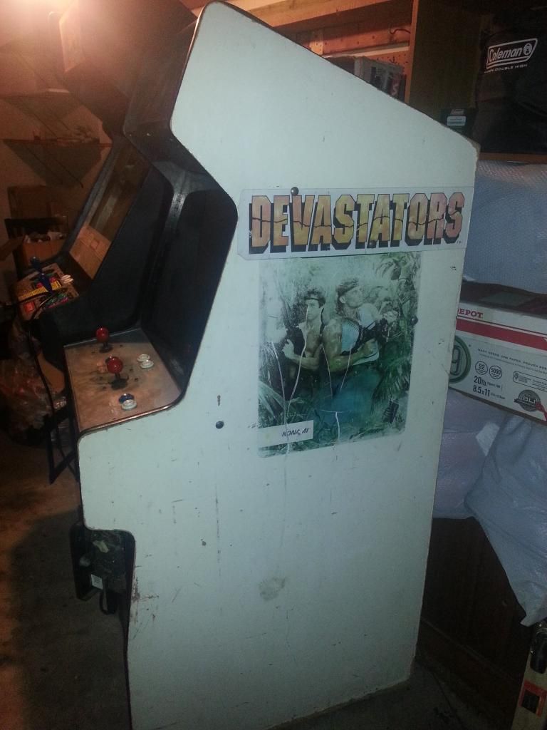

That is not a Joust or a Joust 2 cabinet. That is a factory Konami cabinet. It may have been a factory built Devastators cabinet. I can't find a pic of a Devastators but here is a pic of a factory dedicated Contra in the cab style:
Cool. Thanks for the info. So converting this type of cabinet to a Nintendo blue multicade would not be blasphemy then, I'm taking it?

Maybe, clean it up and re-art the machine as a multi or something similar. Leave the cabinet in the original color configuration so it can be changed back easily later if that's what you or the next owner chooses. New side art, CPO, Marquee in any fashion will make a nice multi without destroying anything. Just my 2 cents.
Devastators cab for sure. Has the original control panel for it. Missing the cardboard bezel and marquee thou.
Jamma cab, easy for a 60 in 1. The only thing I hate about that is that it's a 2 player setup, and only a few select games use 2 players at once. So your off to the side of the monitor while playing and just doesn't feel right.

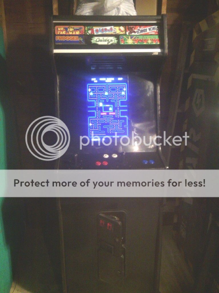

I hooked up the 60 in 1 and for some reason my 19" vertical monitor will not show the entire game on the screen. For instance, in Pac Man I can't see the bottom where it shows how many lives you have. I checked the settings on my monitor and I have a Vertical Size, but no Horizontal size adjustment. Do you have any clue what might be causing this? If I use horizontal position adjustment I will lose the top of the screen with high score, etc. There is no sweet spot. Is this a monitor issue, or board issue?
Please help!
The horizontal size adjustment is on the width coil further in on the chassis, you need a special plastic hex screwdriver to adjust it.
