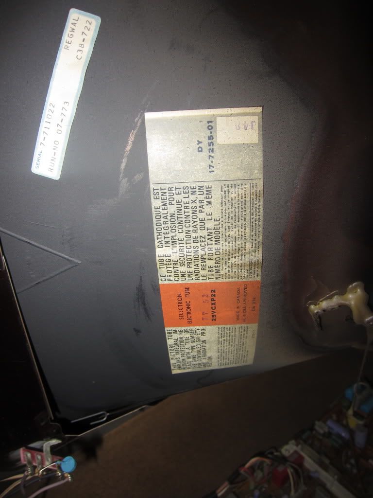

I'm over here at my grandmother-in-law's house tonight and she has a classic Eletrohome 25" color console television. I popped open the back and the tube has 12 pins and the sticker says C38-722 and the model number is 25VCXP22. I'll have pictures up later since her computer here doesn't support a SD card reader. Any direction or cross reference? She's had this thing since new and the actual TV is an Electrohome Festival model made in 1978. She's got the original owner's manual and everything else. Pretty much a time machine sitting in her wood-paneled basement. It definitely feels like I'm on a Brady Bunch episode for sure!
I'd like to help her with some $$ since she's 79 years old and on a fixed income-- if this can be salvageable, LMK. Pics to come later... Ken Layton, anyone??

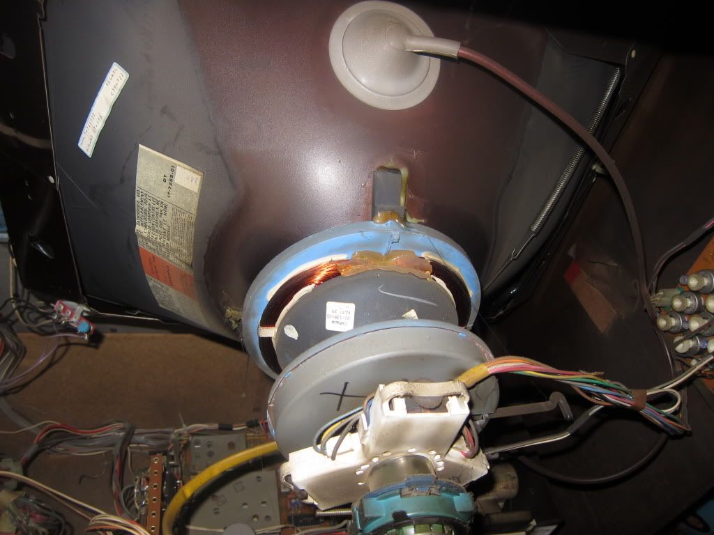

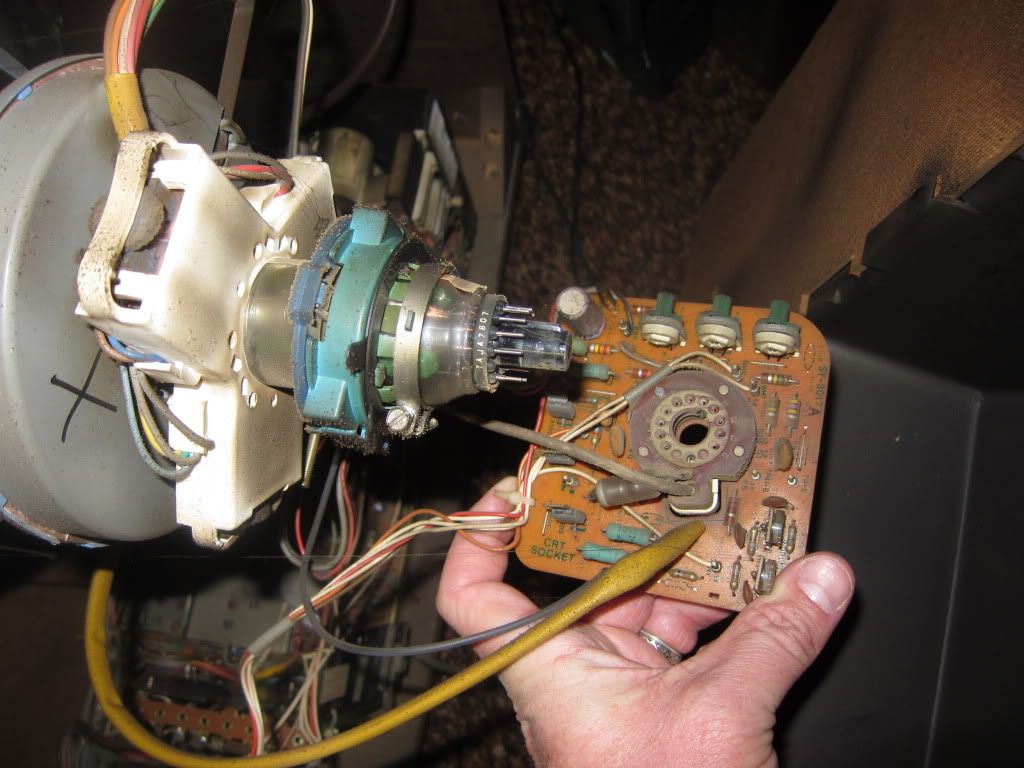

Here are some pictures as mentioned. I have no idea on what to look for with these. I know someone a while back compiled a listing but I cannot find the thread..
Anyway, enjoy..
Whoa, that has some sort of auto or electric convergence
My first impression is a NON match :(
But once all that gear is removed you will get a better idea I guess
