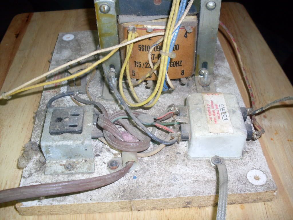

You mean like this?
Yeah, something like that. :)
I think my before pic will be worse though. As will my after pic because I'm not planning to spit shine it. :)

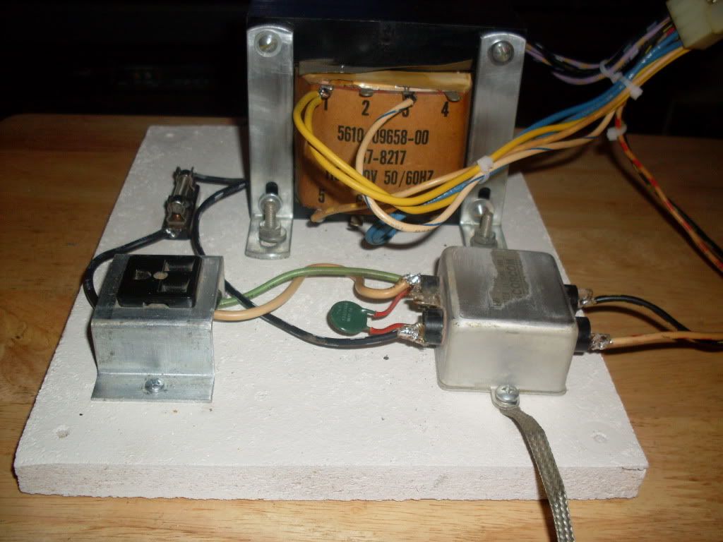

Guess I should have taken better pics of mine.
How did you clean yours? It looks really good!
Well the wires and fuse holders etc, I sprayed with 409 and got the tooth brush after them. Then wiped them down with a damp cloth, rinse the cloth and repeat.
As for the transformers themselves, I blew them off with a compressor, and did a wipe down with a damp cloth. Then with a combination of tin foil, and masking tape I masked everything off and painted the black areas black again.
Then just sanded down the plywood base, and remounted everything.
Just kind of a quick job.

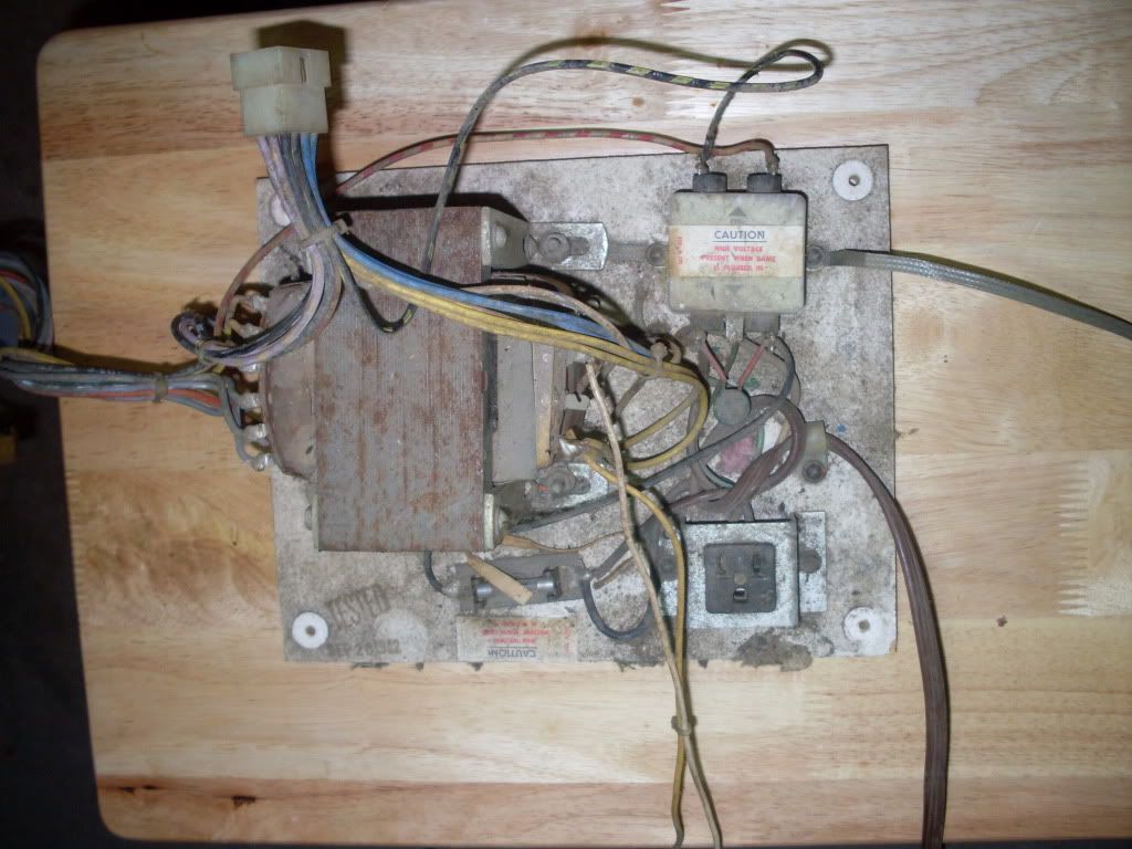

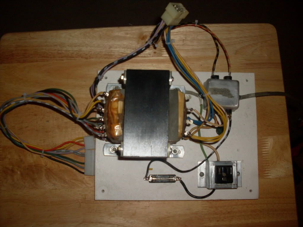

Mission complete!
You can actually see all the components on the transformer block now.
I attacked the power block with compressed air, wiped it down with a cloth dampened with lysol general purpose cleaner, a toothbrush sprayed with the same for the fuses, wires, etc. Then wiped it down it with a damp cloth (water), then got in there with the (new) shop vac and sucked up all of the dust bunnies. Then hit the power brick around the fuses with a hair dryer set on low for a few min to dry up anything I'd missed.
Result: cosmetically the inside bottom of the cab went from an F to a C. It's not sanded, nor is it repainted or squeaky clean but you can at least see everything now and it works fine after testing.
