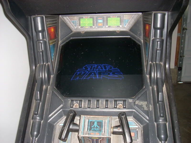

Finally had a chance to work on the cabinet from the electronics standpoint. The first thing I did was replace the power cord and make sure I was ready to power up and check the supply with nothing else hooked up. After testing the power supply I tried powering up the board without the monitor. All I got was a loud hum and the +5 under load wouldn't come up beyond 4.6. I rebuilt the ARII and pretty much got the same result. Next I replaced the power input pins on the edge connector for the main board as they were flat and tarnished. That still didn't get me anywhere other than the board wouldn't freak out when I wiggled the edge connectors. Finally I replaced the big blue and got a stable +5 but still only a thumping noise. I decided to see if the board was doing anything and hooked up the monitor. Here's what I was greeted with...
The game seems to play fine but I have zero sound other than the thud noise from the speaker. I did pull and re-seat all socketed chips on the sound board with no luck. I'm happy the monitor is working and the main pcb is working. :) I still need to do a bit more cleaning on the inside as well. Overall I feel much better knowing two major parts are largely working and hopefully the sound problem won't be too tough to check. I may start with verifying the eproms but I have a feeling the problem will be elsewhere.
