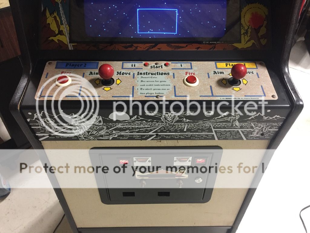

Here is the image on the screen. I fooled around a bit with the adjustment dials on the monitor neck - I can change contrast and brightness, and also tint.
I pulled up all the cards as you suggested and re-seated them.
I tried to coin-up but nothing different happens.
No sound - what I mean is literally no sound. The only thing I can hear is the low hum of the CRT itself. No other sound coming out of the unit.

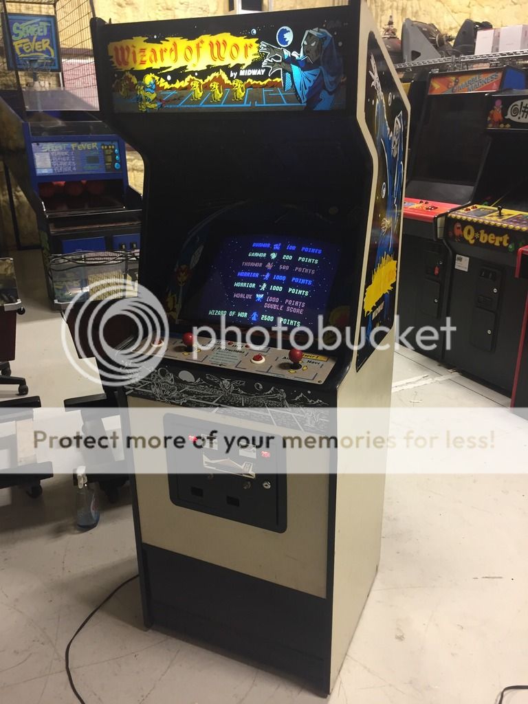

Power supply arrived today. I installed it according to the instructions and now game fires up - I can hear all the attract mode sounds! However....the monitor and marquee do not power up now. According to the instructions for the power supply I was to simply attach the long 19 pin connector to the new power supply and then connect it to 115v ac. I was to ignore the 12 pin connector as, according to the instructions, it will no longer be used.
However, that means the monitor and marquee are not connected to power. Also, with only the 19 pin connector and the ac power connected, all the safety interlock switches and the power switch are also bypassed. So when I plug the machine it, it powers right up, and the only way to power it down it to unplug it.
So I think the instructions are missing a few important steps. I assume I am going to need to somehow connect the wiring harness that goes to the interlock switches, power switch, and monitor and marquee power. Any tips or places to go to see how this should be done so I don't just start blindly splicing wires together? :)
Thanks for the help so far - I am super excited that the game seems to be working - I just need a little help getting to the finish line so I can actually get the monitor powered up as well...
Edit to further clarify: I have the wall ac wire attached directly to the two 115v power poles on the new power supply. I think I need to connect the new power supply to ac power at another point after all the fuses and interlock switches and such. But I am not sure where exactly it should be connected in line.

don't do that! Your bypassing everything that way(fuse and ac filter).
http://www.therealbobroberts.net/acwiring.html
that ac wire to the switcher needs to connect to the ac in the cabinet.
I think the manual that comes with it says to tap the monitor power, but that is wrong. Your defeating the isolation transformer.
you should attach it to the wires at the interlock. I am in brain fart mode right now and I forget if its the inner 2 or the outer two(I think outer two). if you cant figure that out, then use the wires that power the marquee light. Just not the monitor or the 3 prong power plug inside the cabinet. the interlock is in the top right of your last pic under the white plastic.

Okay I see. What I did was cut and splice the wire from the wall directly into the new power supply. I see now what I should do is simply tap into power somewhere along the line. Makes sense. This is my first arcade machine restoration and I was thinking that the new power supply would bypass the entire power assembly including all the coils and such - I understand now. I believe I also need to check all the fuses - I took a quick look last night and one of the fuses near the transformer may be blown.
I will re-tap the new power supply tonight and re-connect the transformer to power. Then check the fuses. It may be that a fuse was the problem all along - but I still like the idea of having the new power supply even if the old one actually does work - so its all good.
I was super excited when I heard the game fire up. When I hit the action buttons the wizard tells me to add coins - so I think once I get this wired right I might... *fingers crossed* be all set. Last potential problem could be the CRT - it does not appear to have any burn in - but at 36 years old it might need some work.

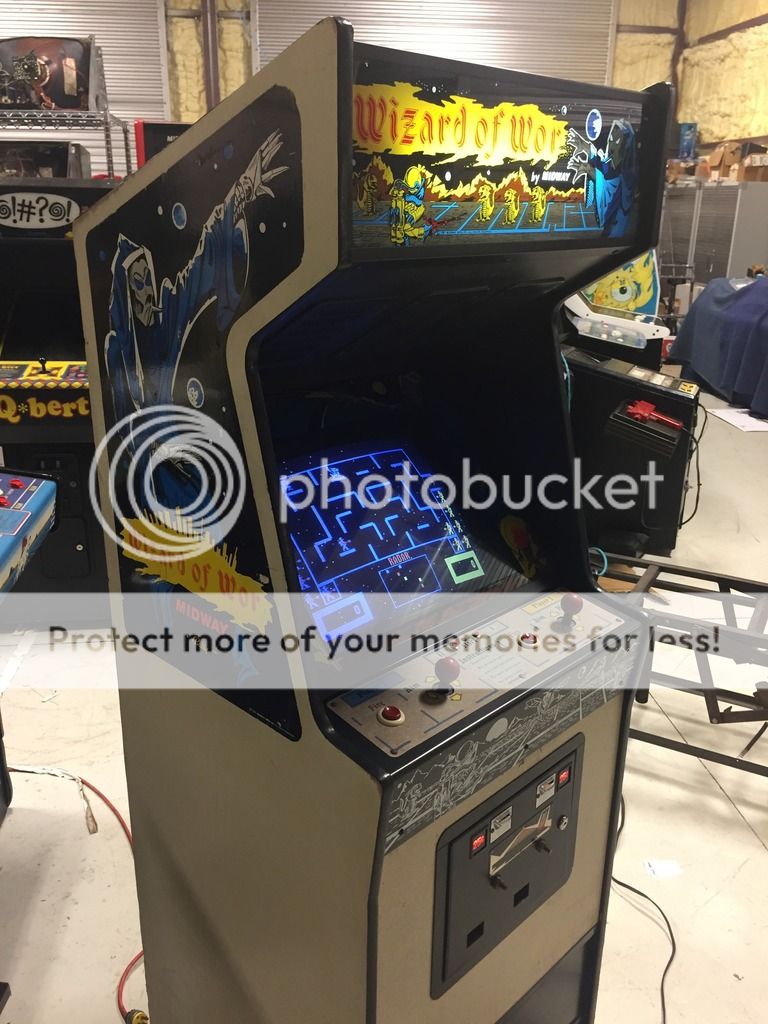

So I re-wired the new power supply tapping into the marque power lines. Now everything lights up and works - but the monitor has a white screen. I can adjust the brightness and such - but its just a white screen. Game is running - I can hear all the sounds, buttons work, and I can coin up and play.
So - white screen crt - any suggestions? Is cap kit next or could it be something simpler? I checked all the fuses and they look fine. I re-seated all the boards and connections last night but I could do that again I suppose...

did you mess with the monitor? with the power off on all of these.
first I would try reseating the cards on the monitor chassis. any change?
on the back of the card that has the video cable, try turning it 1/4 turn and see if it went darker or brighter.
on the neck board there is a screen voltage pot. you can turn that down and see what happens.

Okay so:
- reseated the cards on chassis - no change
- turned pot on back of card that video cable is attached to. When I turn it the screen eventually goes black, then when I turn it back it goes slowly returns to a brighter and brighter white color
- the neck board voltage pot - turning changes the shade a bit and adds some color to the white - then turning it back goes back to pure white.
- When I adjust the other pots - for color - I can change the screen to add a tint of color to the white.
Seems to me that the monitor is working, but the video signal is not coming through. Could be the card that the cga cable attaches to on the chassis? Could be the card on the side of the cabinet that the pcb attaches to before the signal goes to the card on the chassis? Too bad I don't have a cga to vga converter or I could try connecting a vga monitor so see if that would work...
Pure white tells you all the colors are firing. Raster solid white suggests no signal at all to me.. When you are "adding" color, what's really happening is you are taking away color. White is the presence of red blue and green.
