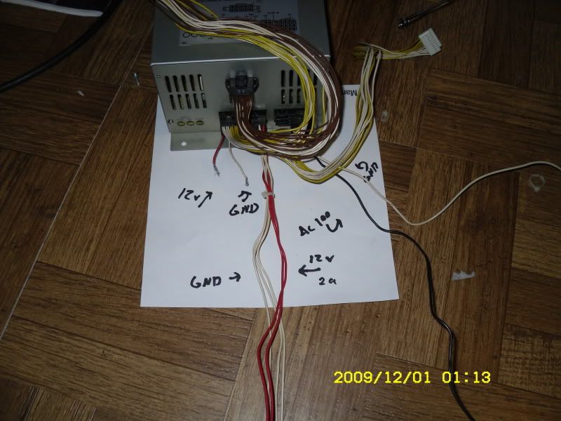

Thanks to a few members here I have a lost world boardset and psu. Ive been talking to Ken westerfield and he said aside from changing the powersupply this is plug and play. My question is where do I even start wiring the powersupply I have never worked on sega stuff like this. Pics incoming. Im not merely swapping the pcb I have an entire board set cage and all. Im going to remove the virtua cop2 and put this in.
Alright guys feel like Im almost home on this one. I decided to use the extra harness I got with the boards to make this easier on myself. My question is do you guys see any problems with me connecting the wires from the psu to the posts setup in the cab? Ive labeled the connections should just be a matter of connect them together?The only probelm I see is there is no pin housing for the field ground in the connector Ill have to find a housing somewheres.

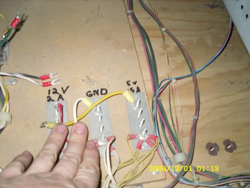

Cab powered up and everything seemed fine, I however noticed there was no +5volt wire that was loose that I could connect. My question is can In splice into on of the yellow wires designated to +5v to power the rest of the harness?
Yes, you can splice into one of the existing +5v wires. They all come from the same source so it will not matter which wire you select.
Thank you very much... Now In have to go to the store Im out of wire nuts arrrghhh.
Hot damn! The 30 dollar boardset and psu works ;-p. Just got the game up and running. Now I need some new guns these ones are junk.
