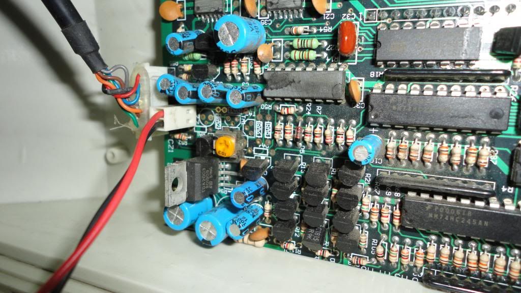

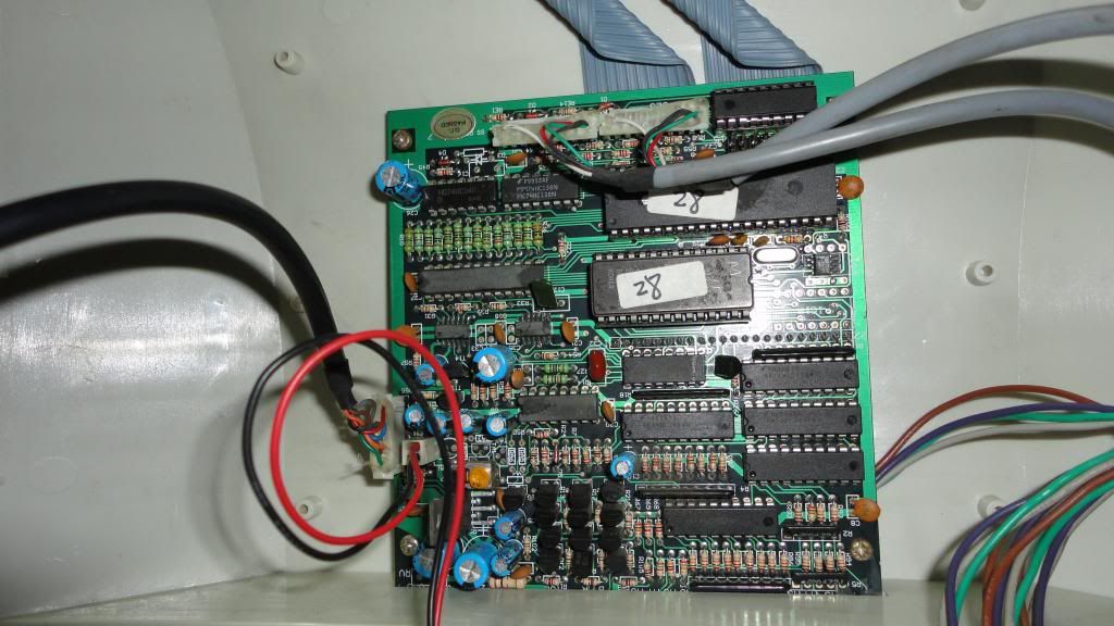

Sound problem...no sound at all!
I have no sound currently and I am not sure where to begin to fix it. Here's where I could start using some input from the world of KLOV technical department...
The manual that includes all the dip switch settings and the list of compatible games (the one where you have to click the link to obtain...not the Word Document that is zipped as an attachment), which I will call MAN1, says that it is very important that you have the -5v connected...
It is reflected in the pinout, which I will call MANPIN1, that it provides as well...
The Word Document manual, which I will call MAN2, has no such warning about the -5v as seen here...
And it is reflected in the pinout, which I will call MANPIN2, it provides as well...
Another part to consider (or not, I don't know so I will put it out there), is that the JAMMA pinout shows the -5v being hooked up to both the Component Side as well as the Solder Side as seen below...
MAN1 and MANPIN1 show the -5v only hooked up to the Part Side of the harness. So I put it out there for thoughts on this matter...-5v on just one side would mean that I need to cut the pin on the Component Side of my MGCD harness if I go with MAN1's instructions? Leave both -5v connected on the MGCD harness because I should be looking somewhere else? Or go with no -5v and see what happens? To try the no -5v I would just plug my MGCD harness into my Die Hard cab which doesn't have the -5v hooked up.

I don't see the ground for sound. Is this a stereo board? It appears to have four different sound out connections and no returns. This may be why you have no sound.
Just tried it in my Die Hard cab and the screen is all scrambled so -5v is required.
I saw the 4 sound connections. Somewhere on the internets I saw the words "pre-amp" next to the L and R inputs. I will see if I can track that one down...there may be yet a 3rd different pinout for this system.
Is this cab wired for sound from the Jamma harness or is sound coming from the MK2 sound board? Do other Jamma games work with sound in this cab?
The voice of reason. I will stick anther board in and see if I get sound. Thanks! I have lots of things all going on at the same time and sometimes I overlook the easy stuff.
Plugged in a 60-in-1 real quick and sound is present so the JAMMA harness does deliver the sound, not the MKII sound board.
OK.
Are there any schematics for the Dreamcast anywhere? What about schematics for the adaptor you are using? I am not familiar with this product.
Also, does it have provisions to plug speakers into it directly or do you have to use a connection to the TV? In other words, I am trying to determine if it has an onboard sound amplification circuit. If it doesn't have an onboard sound amp circuit then you'll need to add one to make sound audible.
The only information available on the Internets is the two pinouts I posted. The adapter I am using is the JAMMA extension harness from Twisted Quarter on eBay right now. I am making my adjustments to that harness because the MGCD is not JAMMA plug-and-play. Once the extension harness gets hammered out correctly, I will do a better adapter. I will get those pix up soon.
Are all of the voltage lines present in your harness? Are the power lines in your harness 18 gauge or are they smaller? Have you tried the volume control on the MGCD?
All voltages are present in the harness. The power wires in the HS-5 are the same gauge as the rest of the harness. The voltage wires on my adapter are bigger than the rest of the wires on the harness. Yes, I tried the volume knob...still nothing.
Everything works except the sound and the fan inside the case. Games load up, credit fine, and play with either a Dreamcast controller or through the HS-5 control panel joystick and buttons.
