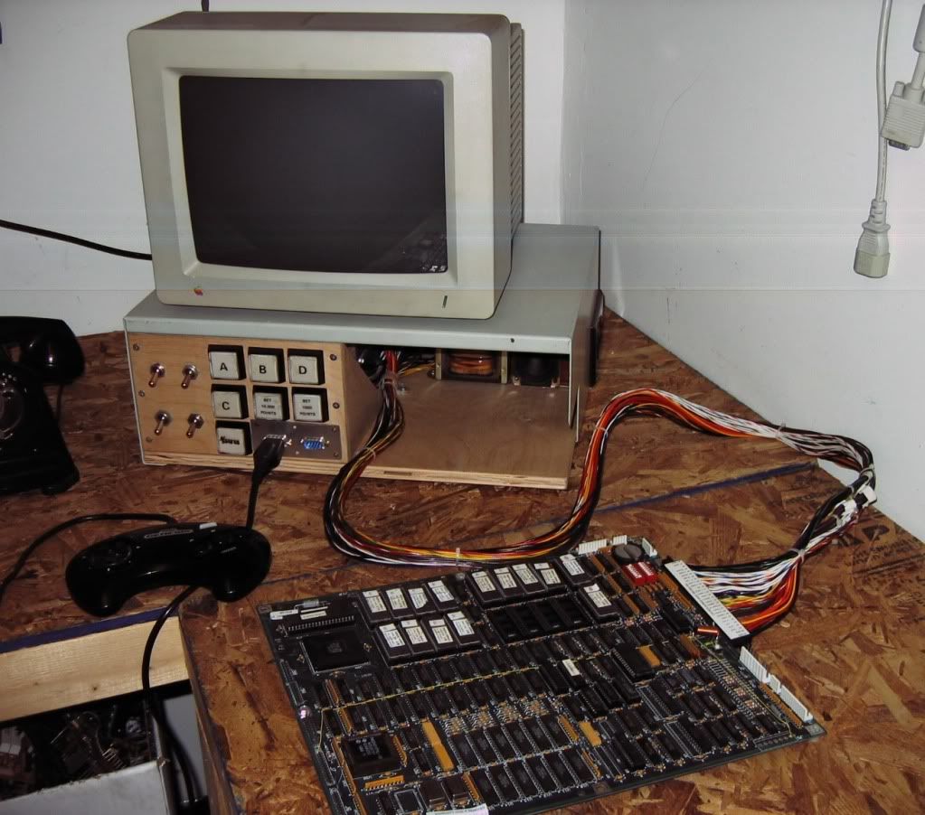

I'm pretty sure I've posted picture of mine before - here's a link:
http://i250.photobucket.com/albums/gg280/RetroHacker/testrig.jpg?t=1306415499
I used Sega Genesis controllers as well. I used momentary pushbuttons (from a poker machine, obviously...) for everything, since that's what I had laying around. The three down the left are test, service and slam, the other four are 1 and 2 player start and coin buttons. I've not had any problems yet, most games only seem to check the test switch at startup anyway. Of course, a bit of tape would easily hold one down.
-Ian
Here's a pic of my mini Jamma cabinet that I use as a portable test bench. The box is basically a case for a switching power supply, with room inside to push all the cables inside. The controllers are Sega Genesis controllers. The monitor mounted on the back is a PSOne. Push in all the cords, attach the controllers to the sides via velcro, the monitor folds down and the whole thing becomes fairly compact. Here's a picture of it testing a Gauntlet PCB to get an idea of scale.
Where do you get the +15V, -15V, and +10.3V for powering Gauntlet??
I've got one, but no OE power supply, so I was just starting to puzzle through how to set up a test rig for it...
+10.3V I believe is just for the coin counters. +12V can be subbed for +15V, and -5V for -15V, though the amplification is not perfect at those levels; you do get full audio though.
Excellent. Thanks! I just looked, and the -15V is just regulated to -5V anyhow. Good to know that +12 should work in place of the +15. I'll hook it up and see what I get!
One more question about your test set-up: Is anything necessary to convert the video signal for the PSOne display?
