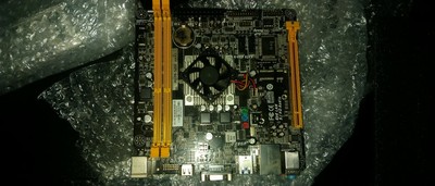

As usual the Biostar A68N-5600 is no longer available except for $765 from Elaut. Does anyone know if a similar board will work? Thanks!!!

Yep, that be me. PM me more information.

I had toyed around with a Raspberry Pi when I designed the
hardware but the Pi's available at the time were too slow to
do what I needed.
Here is one on ebay
Here is one on ebay
Might work. Slower CPU, may or may not have issues communicating with the IO board.
Well since youre here... been having problems with the right side of my wonka, half the time the mobo wont boot and Ill have to jump the pins, half of the time i get i/o communication error. when I get i/o errors it will be loading something delicious, waiting for cpu to settle then it will throw the i/o error or it will boot. i/o error follows the i/o board... pretty straight forward there, however booting issue follows the mobo. two parts failing at the same time?
Can wonka i/o boards be repaired by elaut/benchmark? I have three sitting in my shop, two predate me... or do I have a cancer part killing other parts?
The I/O board is pretty rugged, I put a lot of thought into the design.
First off is the power up issue - I found that if power is interrupted to the MOBO
and quickly restored (such as a breaker tripping) the motherboard will go into a
safety mode and won't restart unless you jumper the power pins. It's not in the manual
but I was able to replicate it easily on the bench.
Next for your IO errors - check the fuses in the top of the machine. If they are
white ceramic fuses immediately throw them out and replace them with glass
slow blow fuses. We found that the ceramic fuses act like resistors when they get
warm and the 12 volts going to the IO and MOBO drops and causes the IO errors.
Also verify your 12 volts at the motherboard connector is exactly at 12 volts (after
you check the fuses). Those little micro power supplies don't regulate the 12
volts. If it's too high or low you may see computer problems.
