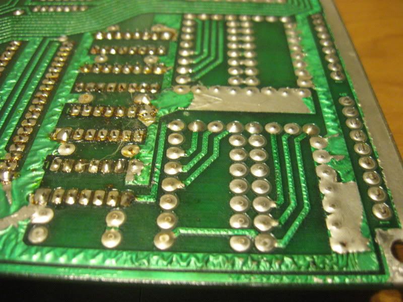

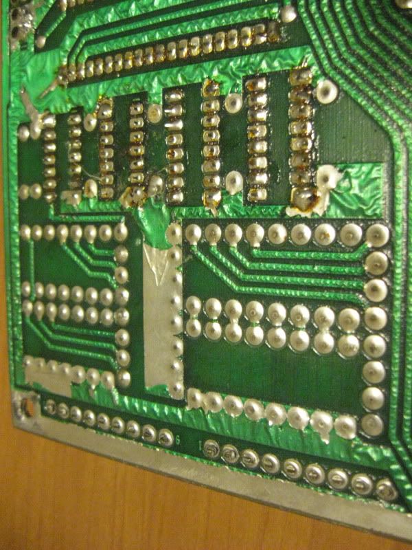

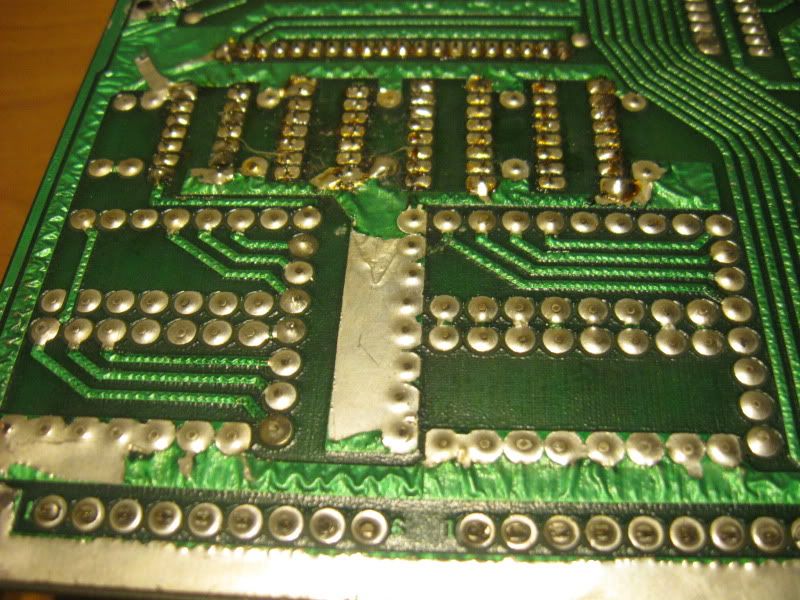

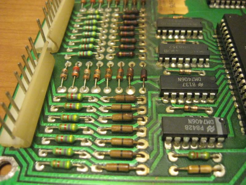

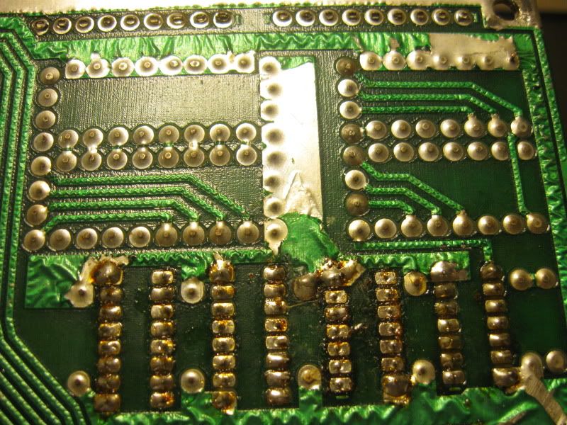

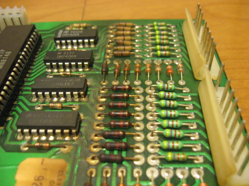

Got a digital camera, and can get me a really good close-up photo of the driver board up near 2J2, front and back? Could be something shorted on the board, such as a really poor solder joint or something. I'd like to see that whole area around IC17/IC18 and the resistors up in that corner..... front and back.

Here are the pictures you wanted. I didn't notice it before, but this area, especially under the ICs, isn't in the best shape.

Yep, just need a diode and the coil situation should be solved.
The switch matrix problem.... hmmmmm. Somebody has already replaced all the switch matrix chips, as well as the PIA. Thankfully the PIA is in a socket, it will make your life easier for sure. Something also got REALLY hot in that area, holy cow (probably the cause of all the re-work). Was it you that tried cleaning it with a q-tip, or was that already there? Most of that is solder rosin, cleans up fine with rubbing alcohol and a toothbrush. Q-tips leave lots of bits of floss as you can see.
Are the other PIA's in sockets? Maybe try swapping them around, see if the problem goes moves with the chip?
The other possible culprit is IC17. It almost looks like the solder is shorting between pins 1 and 2 on top, but that could just be glare in the photo. It's a shame they didn't socket these too when they got replaced.
