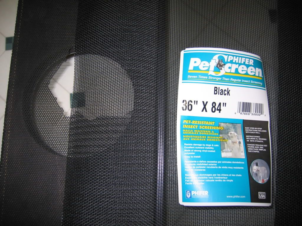

Williams speaker cover mesh...

I'd like to find some of this as well. I have looked at the speaker cover material, but unless you get it very tight and almost stretch it, it will start to sag after awhile. Windows screen netting is close, but again, you have to get it very tight and even the metal stuff will sag due to the weight of it.
Does anyone know the real name of the product that Williams used? If I could find it in metal, that would be even better.

I think I found a solution. I found this "Pet" resistant screen material for doors and windows at HD that has thicker strands than normal screen replacements and is pretty damn close. It comes in a huge role and is $16.

This stuff works great. I've re-covered a few Williams speaker grills with it (Joust, Robotron, Moon Patrol). It's easy to stretch, and staple down.
You can find it at ACE Hardware.
