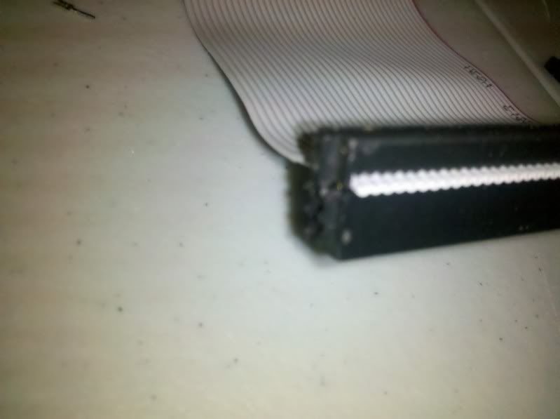

Where would I go to purchase the black connectors that crimp onto the end of the ribbon cable? The connector that plugs into the MPU board.
In the process of replacing a ribbon cable on a rom board, I have broken the lock tabs off of 2 old connectors during the clamping process.
So I need to find a source to buy replacement connectors. (not the whole ribbon cable, just that end connector)

If you have a Fry's nearby, they usually have them is stock. Check for electronics shops near you. Those are 40 pin cables that are used in a lot of computer hard drives. So most computer repair places have them, one may be willing to sell you a couple.

I usually just get scrap 40-conductor IDE cables and cut them in two and that way the ends are already crimped on. I then just remove the cap on the EPROM board and crimp the new ribbon into place. Worked for me every time.

The trick is removing or replacing a cable without damaging the connector. I'll never understand why Williams used these connectors on their rom and interface PCBs.
I was considering soldering in new male IDE headers on my rom and interface PCBs so I could easily change cables, which would only need IDE connectors on both ends.
Do you have any special tools for removing/replacing cables on the standard Williams rom PCBs?

I just use a vise with a piece of rubber on each side of the ROM board to "press" the ribbon cable in place on the existing connector.
I agree, it would have been wiser for Williams to manufacture the ROM board like they did with their sound card - with a 40-pin connector instead! Cables could've been replaced in seconds!
The last one of these I replaced the cable on I found a used connector in a big box of ribbon cables that came from slot machines. There is a special tool for crimping the IDC ribbon connectors. I use this on the open side and the side that is soldered on the board I use a small vice. Just be sure to shim it so the board doesnt get damaged.
If you need a specific connector I can look in my box(s) of ribbon cables to see if I have one.
I use a jewlers screwdriver and an exacto knife to carefully pry the locking tab loose.
