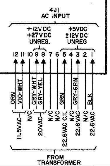

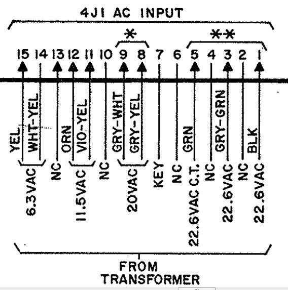

Unfortunately, if you look, the terminal at the top right side of the bottom photo (the new-old PS) is 3 pins smaller than the same terminal on the old-newer style power supply (the bottom right terminal in the 1st photo above). Now, it's keyed, and when i put the connector up to the power supply correctly with the key aligning, there are 3 wires from the connector hanging off the end of the terminal...
...that can't be right, can it?
Does anyone have the pinout for both these supplies? I really don't want to destroy the PS or boardset.
The other terminals appear identical... the one in question is the AC in terminal/connector from the ISO...
EDIT: I found the pinouts for the "older" version power supply (3 connectors)... still looking for the newer version pinout...
I'm pretty sure that's fine. i seem to remember having that problem before and it working just fine. besides, how could NOT hooking up wires blow up your board? At the worst, it just wouldn't start up.
The overhanging wires are the 6.3VAC wires, that aren't needed at that connector for the 2nd power supply.
Here are the pinouts of the two.
1st PS:
2nd PS:
:D
